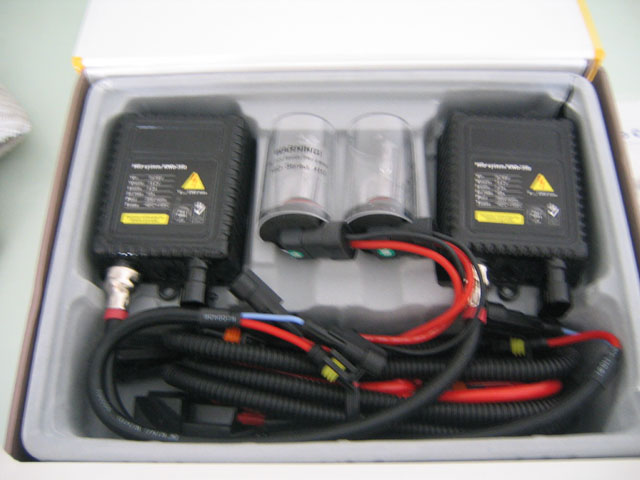

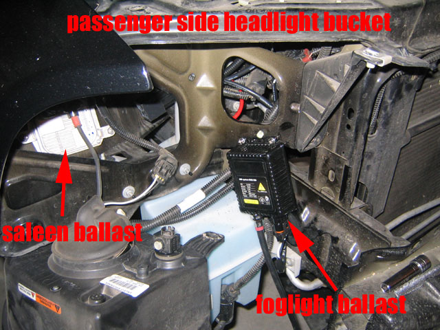

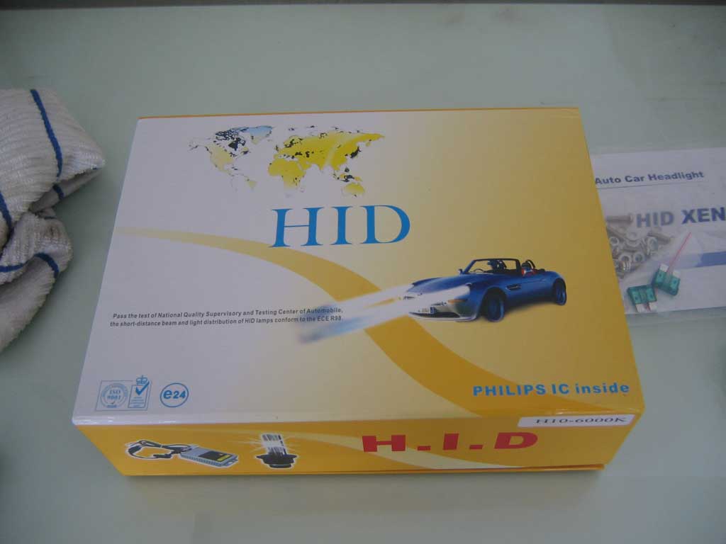

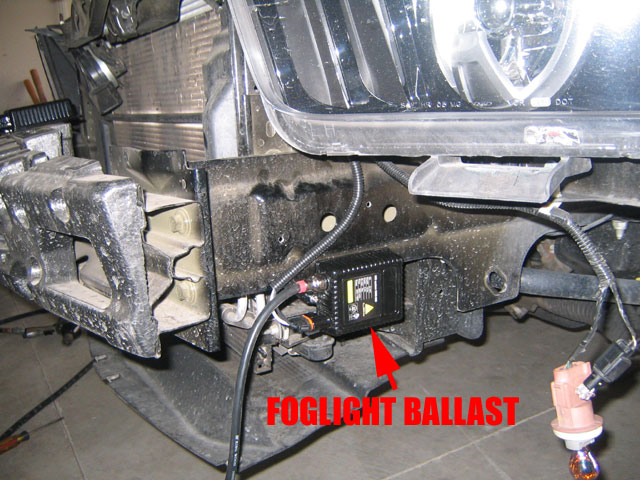

More pix...
Here is my HID foglight kit, and ballast install locations.
Let me know if you guys need more info.
