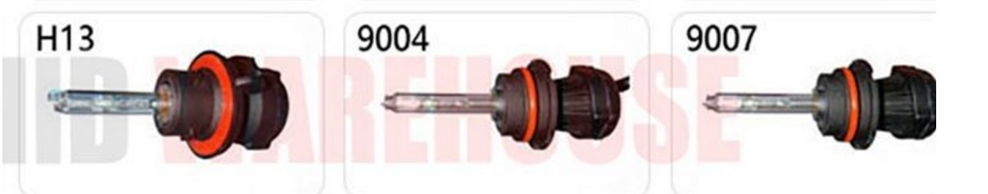

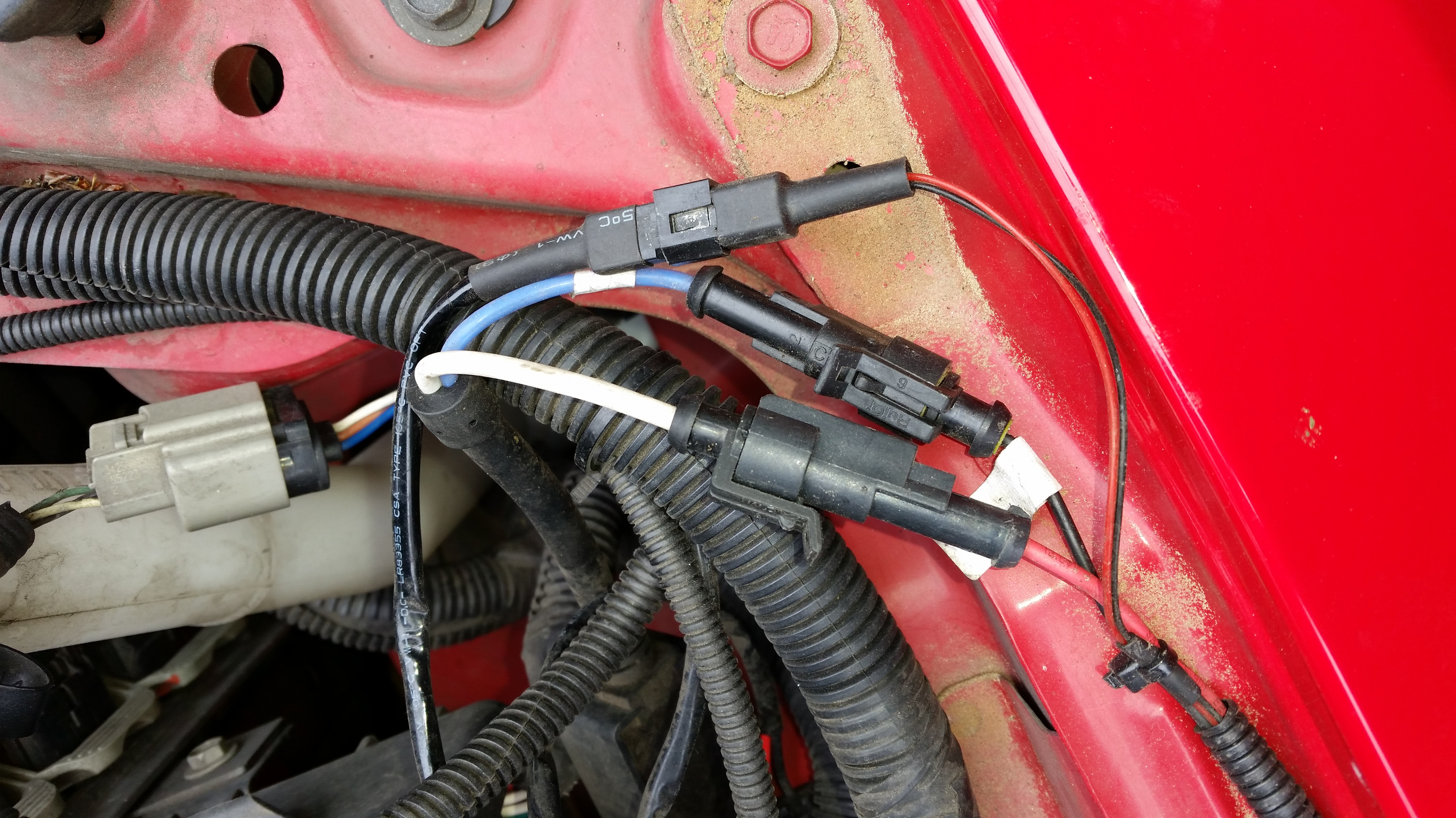

I bought my 2006 Mustang last year. Today I noticed a burned out headlight and noticed it was an aftermarket HID setup. I called the company which I think is VLeds now, but this just seems like too much hassle to replace a bulb.
Considering going back to OEM. How much trouble would that be?
Vleds has similar looking HID bulbs to what I have now, but the connectors on the lamp fixture don't look the same. I don't seem to be able to remove the bulb itself.

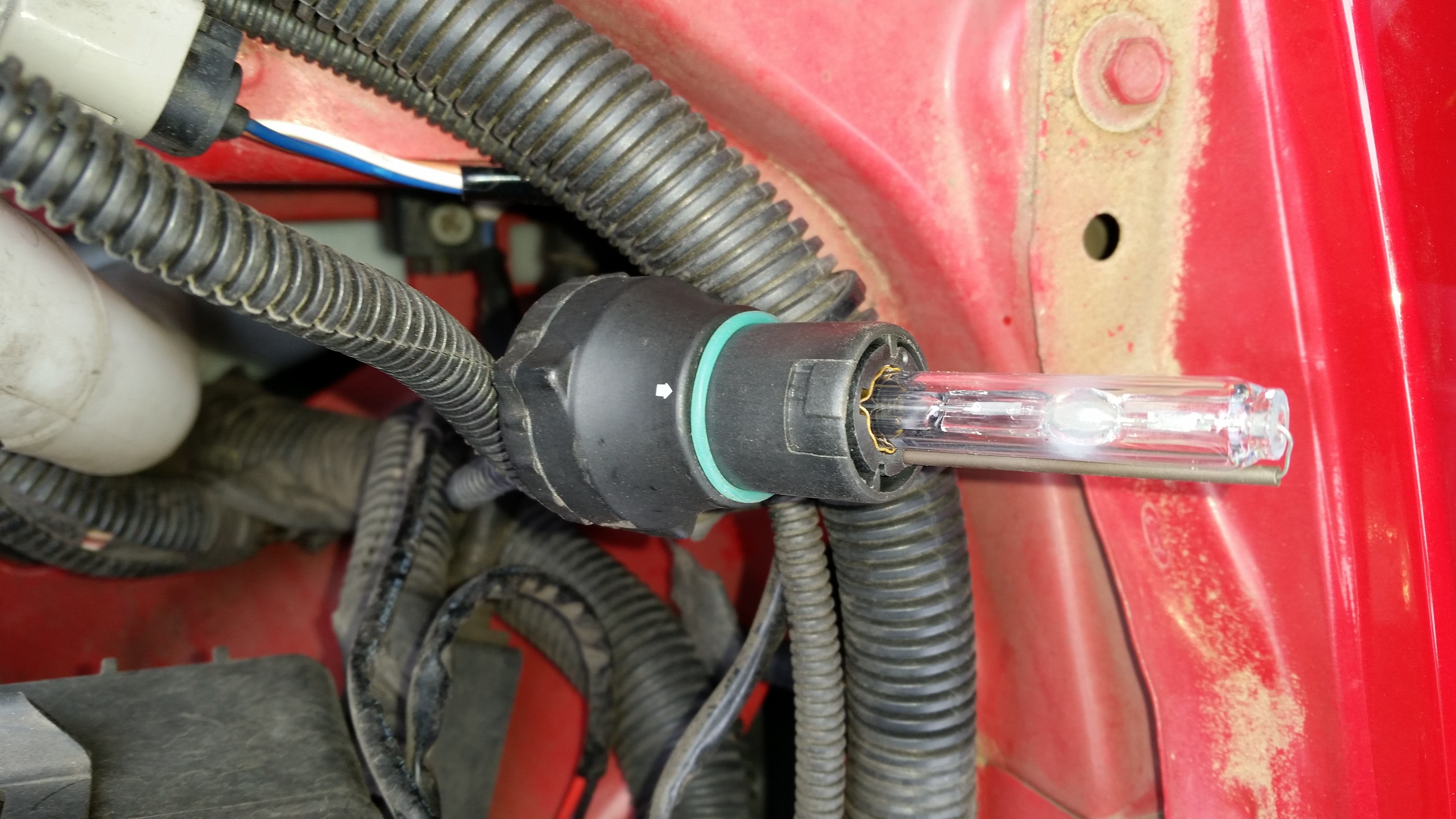

I don't know if they are projectors or reflectors. Will have to take another picture. Here's a picture of the connectors to the lamp/bulb
Attached Thumbnails HID bulb replacement -- or back to OEM-hidconnectors.jpg

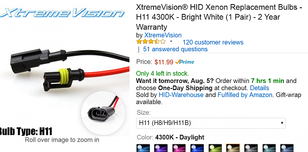

This set of replacement HID bulbs on Amazon looks like it might have the same connectors. To avoid a hassle the next time one goes out, I'd probably want to keep a few bulbs and ballasts on hand ( if it proves too expensive to have my shop set me back to OEM headlights -- I'm not going to do it )
http://tinyurl.com/goe55g3
Sylvania bulb guide shows this for 2006 base Mustang:
SpecificationsSilverStar UltraSilverStar zXeSilverStarXtraVisionBASIC
Part NumberH13
Bulb Types It Fits 9008, H13 9008, H13 9008, H13 9008, H13 9008, H13
Attached Thumbnails HID bulb replacement -- or back to OEM-replacementhidbulbconnectors.png   HID bulb replacement -- or back to OEM-replacementhidbulbh13amazon.jpg

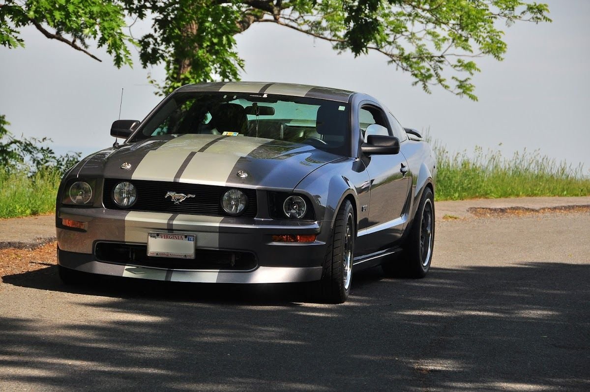

Here are two shots of my headlights from the front

Those are reflector, not projector lenses. Joeywhat has a good point, HIDs in those blind other drivers.

Yeah both the pic of your actual connectors in the car and the Amazon item look exactly like the right ones (sorry -- a little late now though now that you're back to stock )

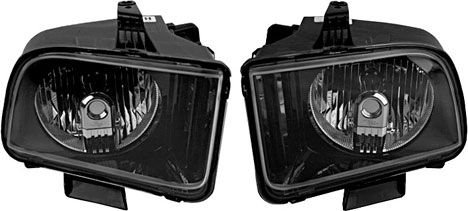

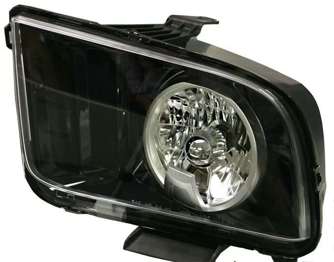

If you do a proper setup, you're going to have to replace/modify the whole headlight assembly, yeah. Ford OEM and Saleen HIDs (reflector type) are both very nice setups and are going to be a significant improvement over halogen lights. I personally of these because they look pretty much like stock headlights.
OEM HIDs:
Saleen HIDs:

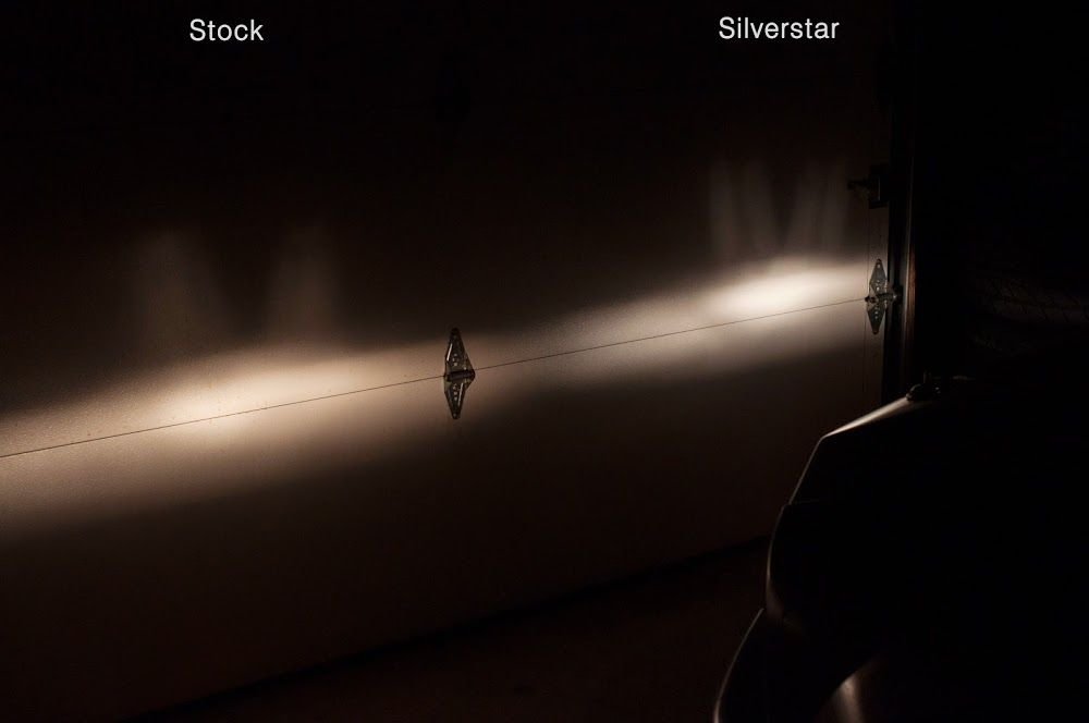

As far as beam patterns/brightness go, here is the stock sylvania bulbs vs Silverstar:

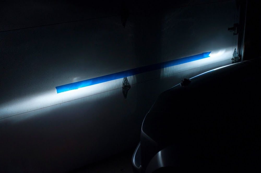

And vs the Saleen HIDs:

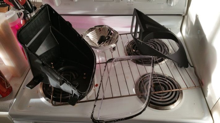

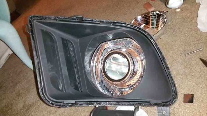

With projectors, BTW, some assembly required:
(from a thread on another forum)
