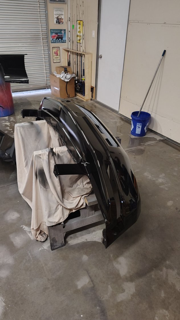

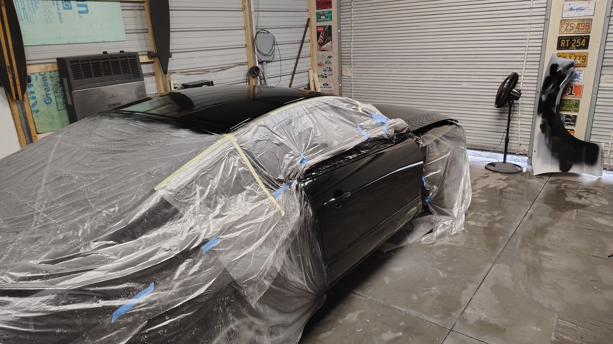

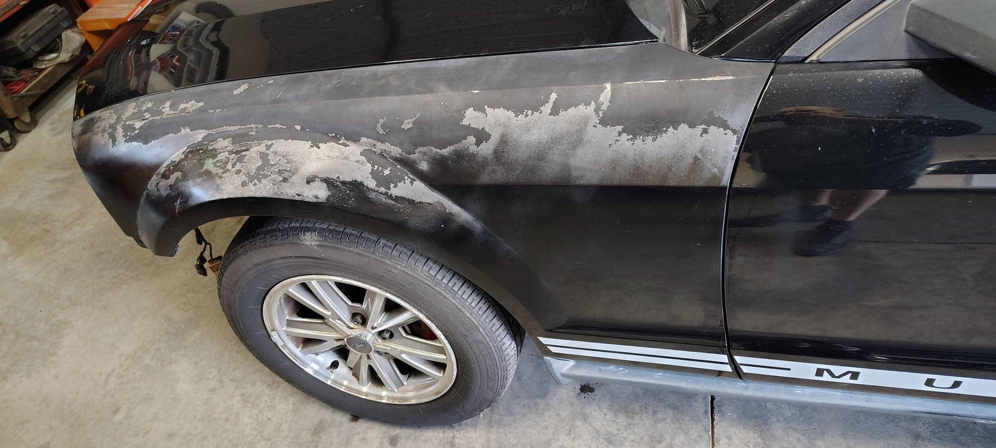

I know this topic is probably been beaten to death, I've seen some posts that helped but still hoping for some advice. My oldest son bought an 05 mustang last year, had a very minor fender bender and a week later some stopped up converters so I inherited the car. I did some painting years ago but it was not with the base coat clear coat system so I thought I would give it a try. The paint on the roof, hood, the top of the passenger door and one of the fenders had issues so I thought I would redo the roof, hood driver side fender and the passenger door. I replaced the damaged passenger side fender and repaired the bumper cover. Sanding everything down went well, the sealer went on smooth and the base coat went on smooth but I kind of screwed up some on the clear coat, mainly on the hood which I blame on some poor lighting in my garage. I didn't have any runs but I do have some orange peel. The car looks great from 10 ft away.but not at all happy with the hood. After watching a ton of videos and researching a lot of forums, I went out and bought some wet/dry sandpaper, rubber block, spray bottle and the magiars cutting compound. I started on the passenger side door because there was some imperfections in the clear coat, did the wet sanding with different grits then tried the cutting compound with a buffer just like the YouTube video stars do and it did not quite turn out like it did in the videos 🤔. So I'm looking for any ideas or suggestions because I really don't want to resend and repaint the hood and I would like to make the roof look better. The car looks great from 10 ft away but the clear coat on the hood and now the dull part of the door is shifting my OCD into overdrive. The painting and clear coat was done over a week ago and it has set in the garage since, I waited for a week before attempting to smooth out everything. Is the wool pad better than the foam pad to apply the compound? Will waxing after the cutting compound make any difference, does a clay bar system help any with fixing the clear coat issues?
