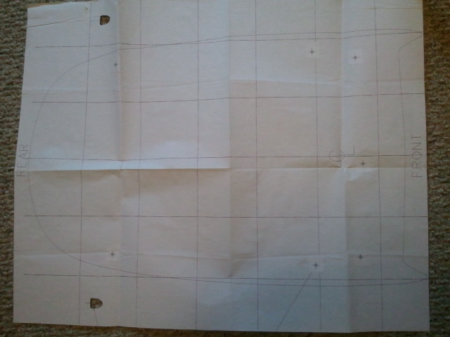

Thats a good idea AK. You would just need a center line to center on the hood, and the scoop locates off the wishy washy sprayers. Ive got my pattern from my roush scoop. Ive let a couple guys use it. PM me if you want to work something out

Looking at that template, looks like the one that comes from AM with their scoop .....
Look at the three holes nearest the front that are for locating the black insert. In the picture, looks like my template did, the two outer holes are not in line with the center hole and in my case the clip on studs came undone in use ..... so I did a R&R adding two more holes and sealing the two extras, using fishing line to cut tape and using new tape after a lot of peeling, etc..
Look at the scoop and front insert, if the holes are in line on the insert, likely they'll need be more in line than that template.
