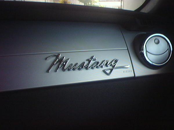

Dude for my '68 Mustang script emblem it had three pins, all i did was get some strong wire cutters and snapped off the pins low then got some heavy grain sand paper and sanded it down to the point where the cut pin was lower then the edge of the emblem and it fit perfect and cheap or no cost at all (in my case) oh and the pins on those '68 fender emblems were METAL so it was A LOT more sanding to get rid of the pins but plastic should be easy and quick

Here is the emblem on the dash

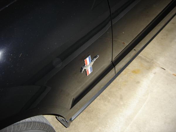

Here she is...

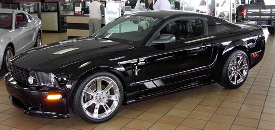

First of all, thanks to everyone who replied to my original post. I was able to successfully remove the pins from the back of the emblems. I've posted a few pics of the finished product. For my next mod I'm thinking about adding 05-06 Saleen side panel stripes (silver)...see other picture. I always value your opinions, so let me know what you think.

A crude photoshop of what my car might look like with the pony emblems and Saleen stripes.

I personally like the Saleen stripes... my only issue is that I feel they are too small... if they were combined with the Steeda stripes in a design that was part of each (without the Steeda Sidewinder symbol) and that faded away the further it went back on the door.... I think that would look awesome......

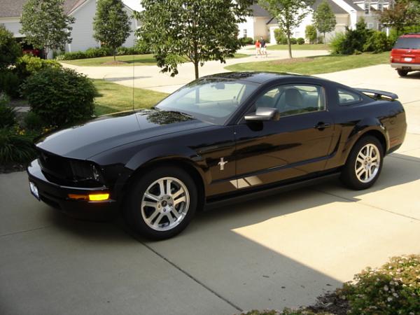

The finished product!!!
2005 V6 Mustang - Premium package
Modifcations done:
- replaced tires/rims with stock GT tires/rims
- added tri-bar pony emblems (stock OEM from '06 model)
- added OEM Saleen panel stripes
That's all I'm planning to do for now. Maybe one day when they come up with a quality GT grille conversion kit I'll slap that on.
Alright, let me have it guys...what do you think?
