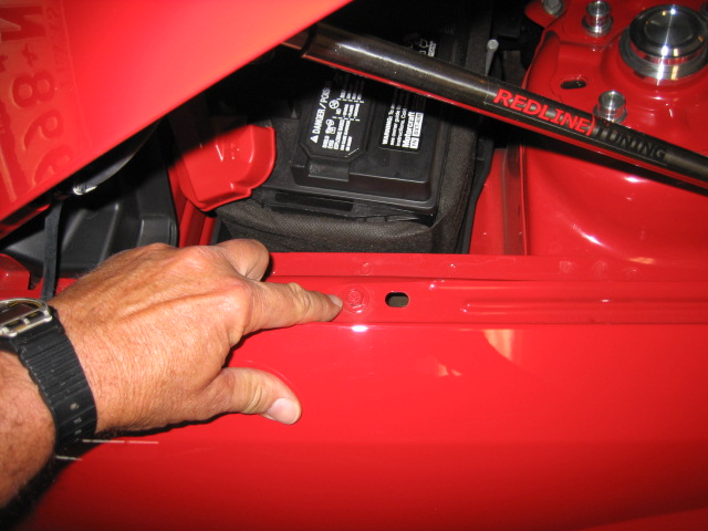

Fender bolts. There are four on each side. Have the hood bolts loose also when you are adjusting. If they test fit it, you should be able to adjust it to fit also. Maybe they just didnt tighten all the bolts.
Ok, what do they hold or cause to adjust? this is a new one on me
Normally they are used to make a consistent hood fender gap. Just do it.

Posts: 1,538
OK, loosen these bolts (all four and these just hold the fender), loosen the bolts that attach the hood to the hinge and not the hinge to the body correct?
