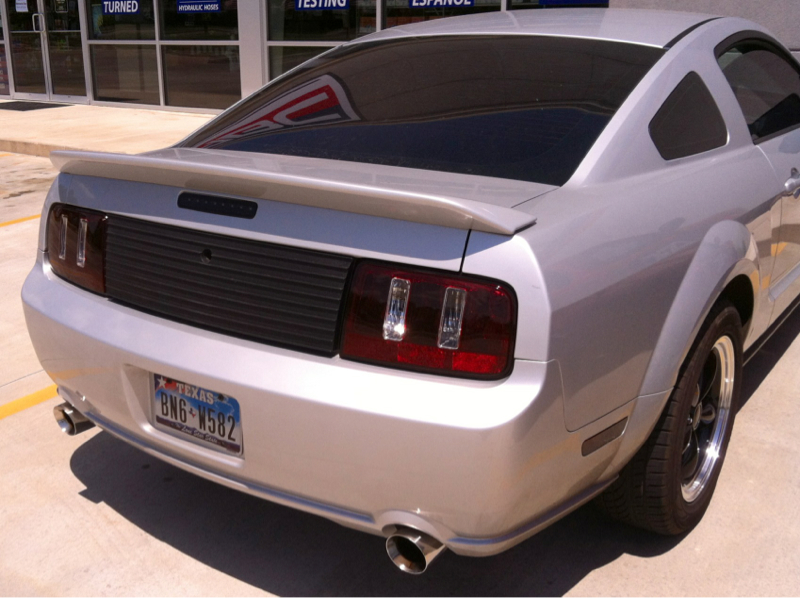

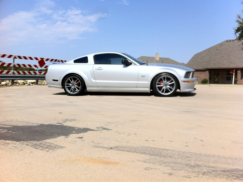

Very easy conversion, hardest part was removing both tape pads from the decklid. Just take your time remove it....

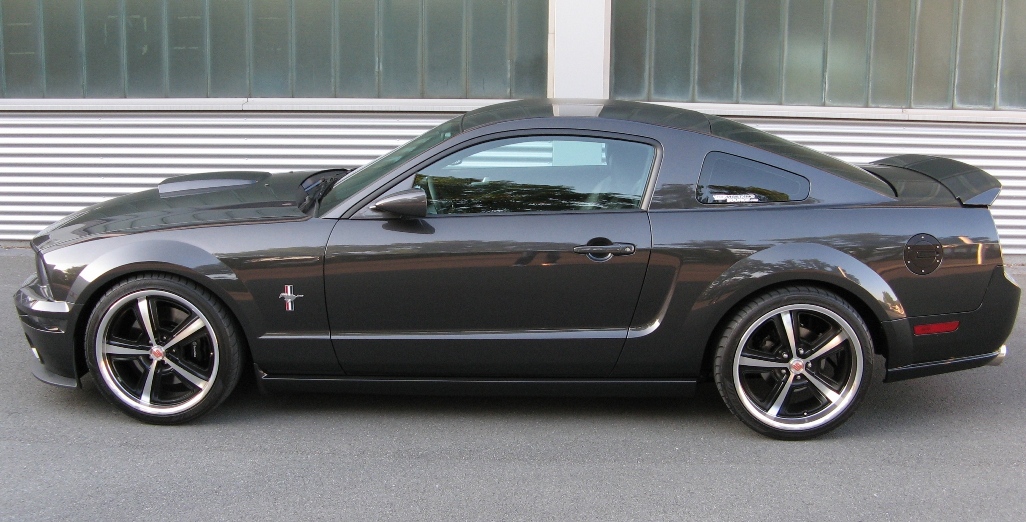

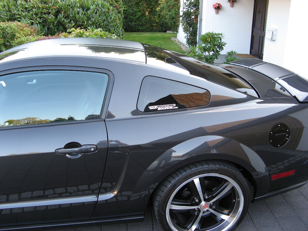

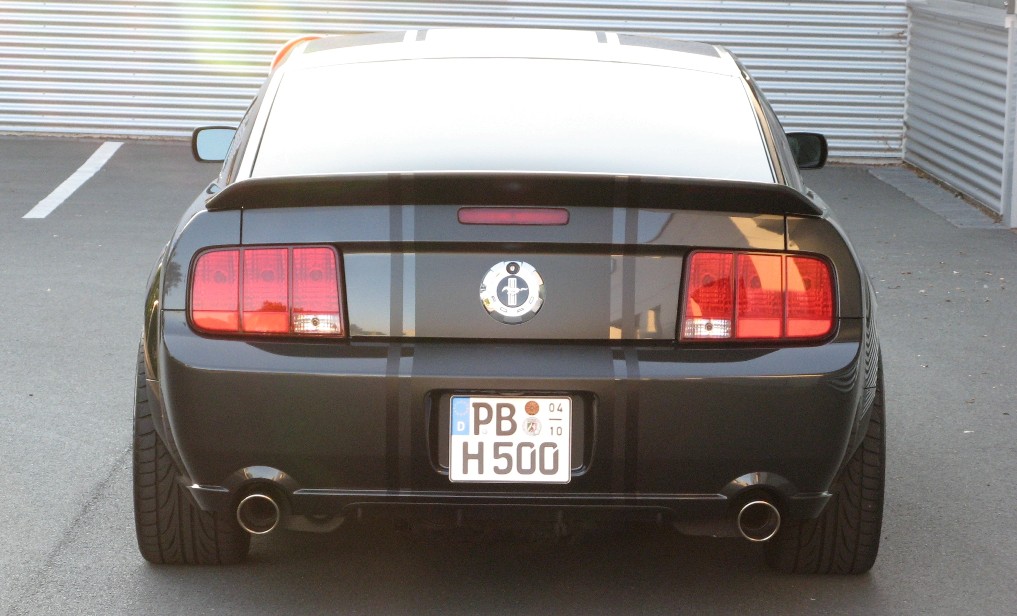

here we go...
Attached Thumbnails GT500 spoiler vs stock GT spoiler?-img_0052.jpg   GT500 spoiler vs stock GT spoiler?-img_0058.jpg   GT500 spoiler vs stock GT spoiler?-1.jpg   GT500 spoiler vs stock GT spoiler?-img_0054.jpg   GT500 spoiler vs stock GT spoiler?-img_0057.jpg

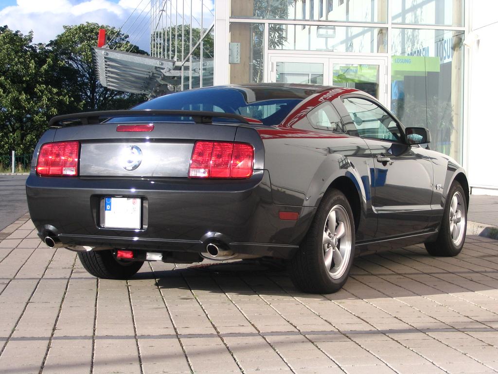

and stock...

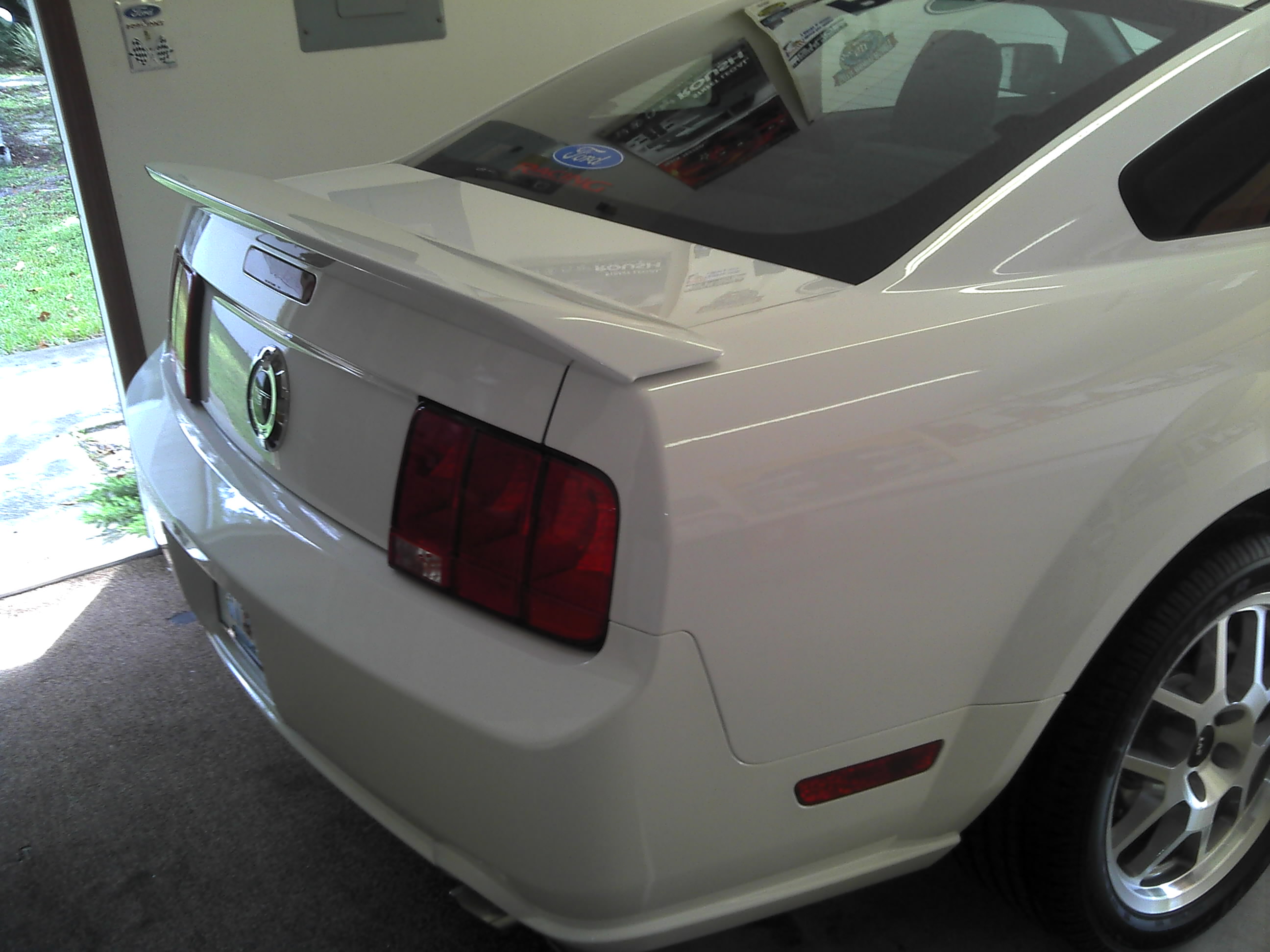

Just take the nuts off of the 4 bolts and use the fishing line to cut though the adhesive. I forget what cleaner I used to remove the rest of the adhesive, but just take your time.
The gt500 spoiler looks great and I haven't regretted the swap in the least.
I went with the OEM Ford piece. It uses the 4 bolt holes like the original. I believe some of the non OEM versions only use 2 of the bolts, which requires you to plug the unused holes.
Here's a picture of mine............
