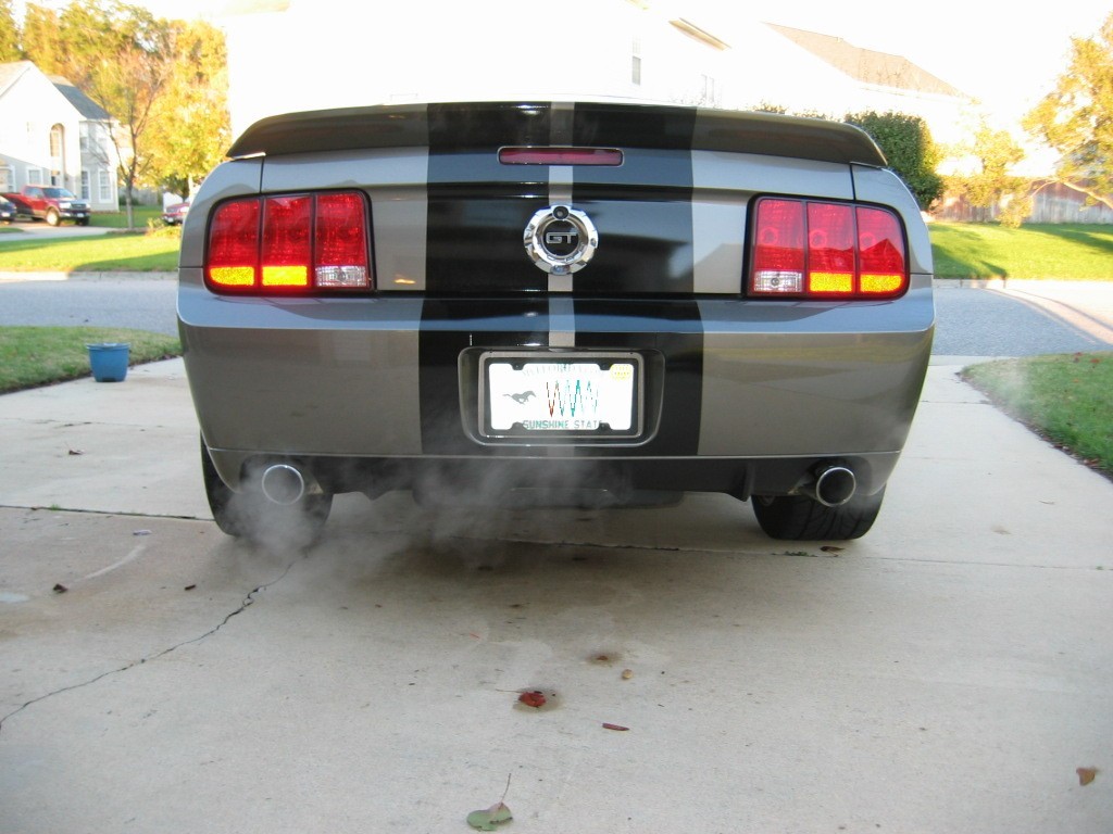

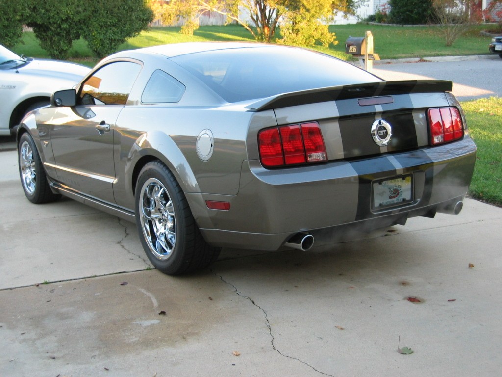

If I order part # 6r3z6320049ba GT/CS bumper cover is there anything else that i need to replace the stock cover? I'm kind of liking how Brad's rear looks.
Rich ~

pretty sure thats all you need

yes, that is all you need.
btw, from what i understand, the little straps that are on the bottom center of the bumper do not line up for the pre-2007's. most people either cut them off, or drill new holes for them.

KC's thread should tell you everything you need to know. At some point in the future I will be doing this too...I hope.
https://themustangsource.com/showthread.php?t=456360

The "accessory kit" upgrade is cheaper than a accident replacement, go figure. Talk to KC

I installed the accessory version and everything lined up fine.

For mine, I had to drill one hole in the bracket near the evap emissions stuff for the center support strap, there wasn't a hole there on my 06. Other than that, it went right on. I went with the accessory kits front and rear, had everything needed to do the job.

if anything, ^^that
