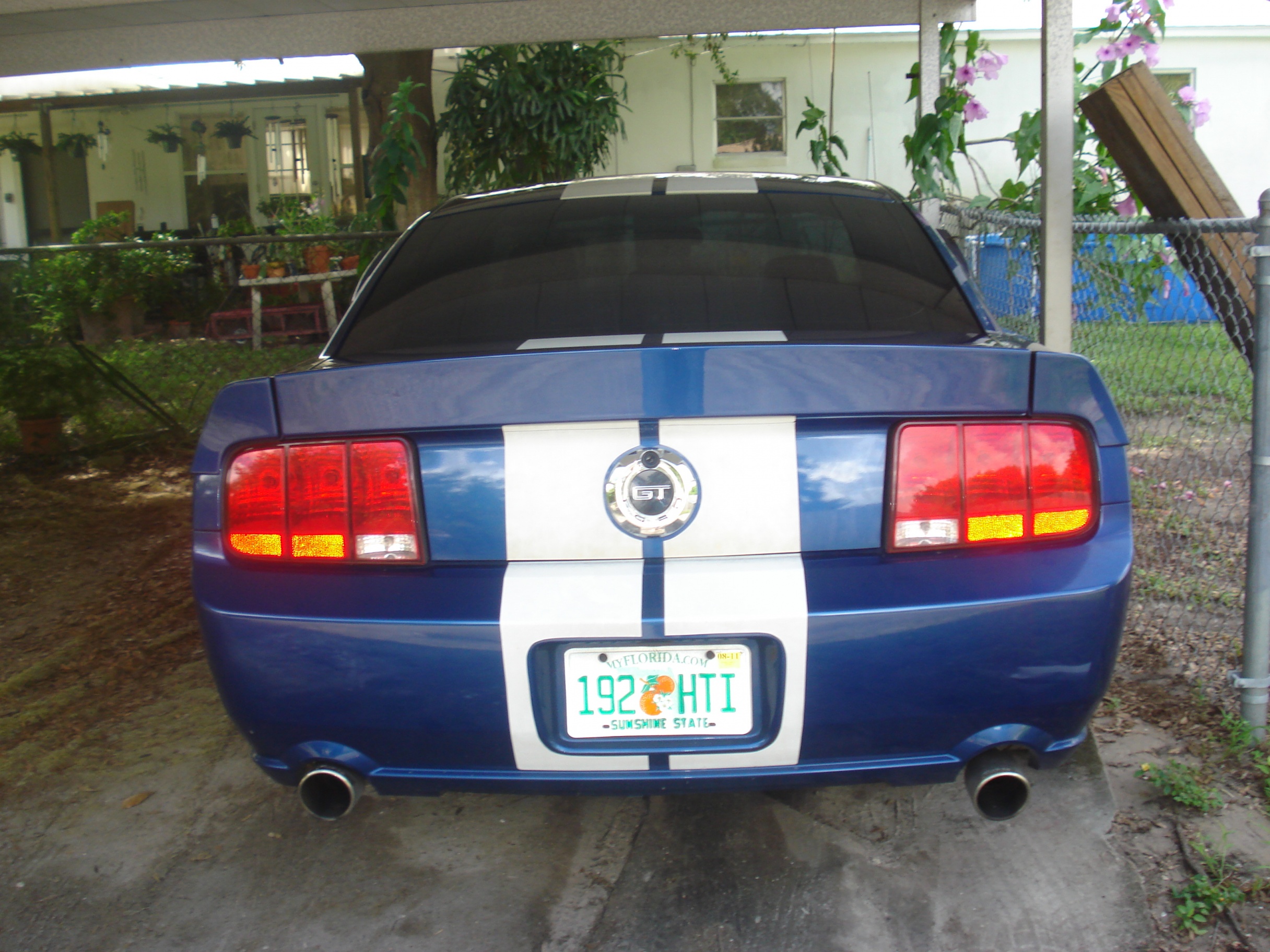

That was strange with your timplets. Mine lined up spot on. And mine didn't have the break light cutout.
Attached Thumbnails Foose Stallion Rear Spoiler install or, WTF could go wrong next-dsc03521.jpg
