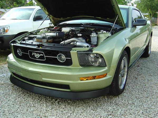

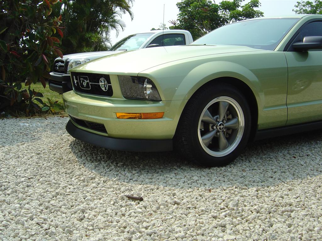

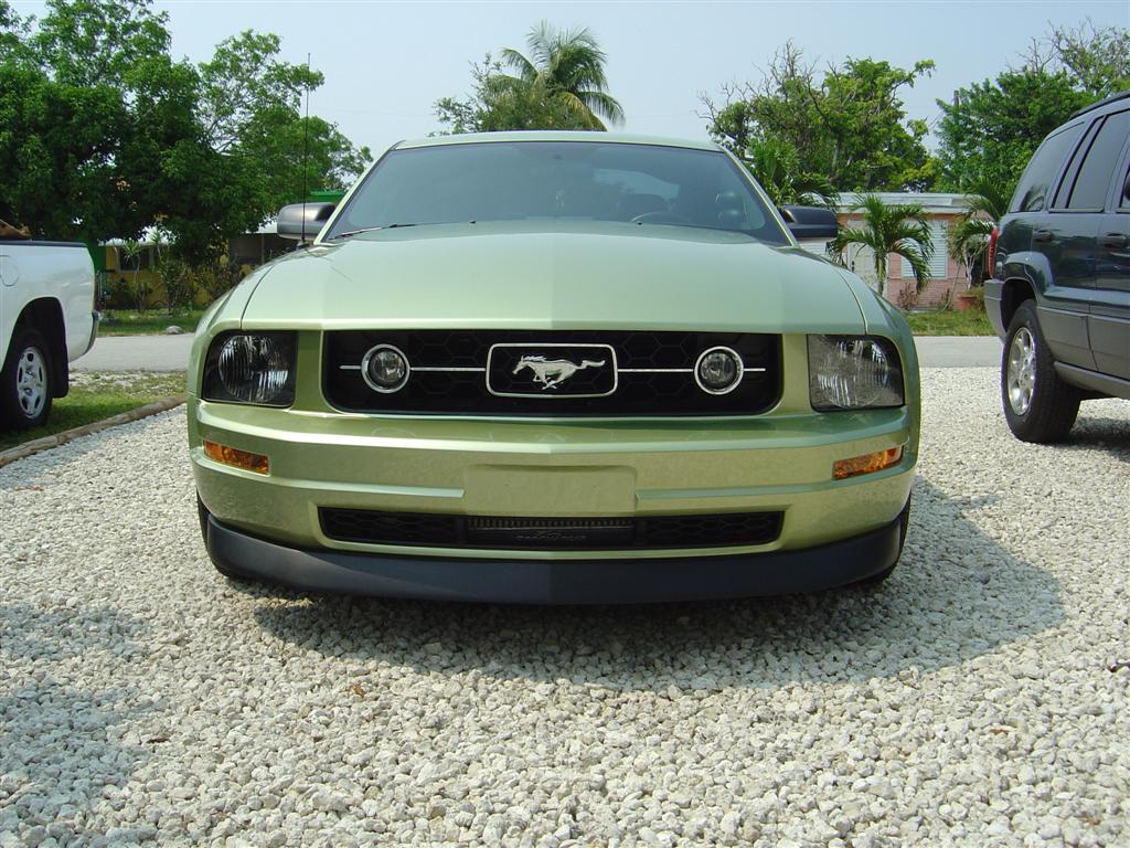

I just installed a fang chin spoiler on mine today...... I purchased it off ebay.
You have to paint it, as it does come unfinished. I was able to do that with some primer and some flat black paint. I feel that it came out pretty good.
The spoiler bolts on to the lower portion of the bumper cover. You will have to drill six holes. That part is pretty easy, you will just need someones help to hold it in postion while you mark where the holes will be.

I jacked the front end up and put it on stands. I didnt want to install it on ramps only to rip it off when I drove off.
As far as painting, the spoiler comes in pretty good condition. I did have a couple spots that I added spot putty and had to sand. Use fine grit sand paper as the part is already pretty smooth.
When painting use thin, light coats as apposed to heavy coats.

Great looking spoiler.
I want one for my V6 Pony Package!!!!!
