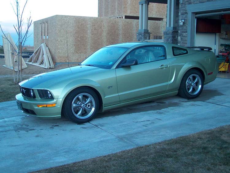

I changed out my 17" Ford bullitts to the FRPP 18" black bullitts..with no problems and no steering stops.They were not listed in the 06' FRPP cataloge.
Attached Thumbnails Factory wheels to 18" wheels-hpim0159.jpg   Factory wheels to 18" wheels-hpim0171a.jpg
