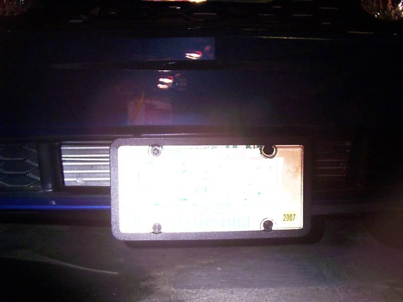

At the dealership, they take a drill to two little pilot dimples in the front bumper. They then screw two large self tapping screws through the plate into the bumper.
I strapped a plastic plate support (Bell) to the lower black plastic below the bumper using soft, strong velco straps. I put a piece of heavy felt where the bottom might touch the paint down near the ground ( it rests on the center post). It is very sturdy (even at high speed) and comes off in minutes.
Attachment 944
I need a better picture.
