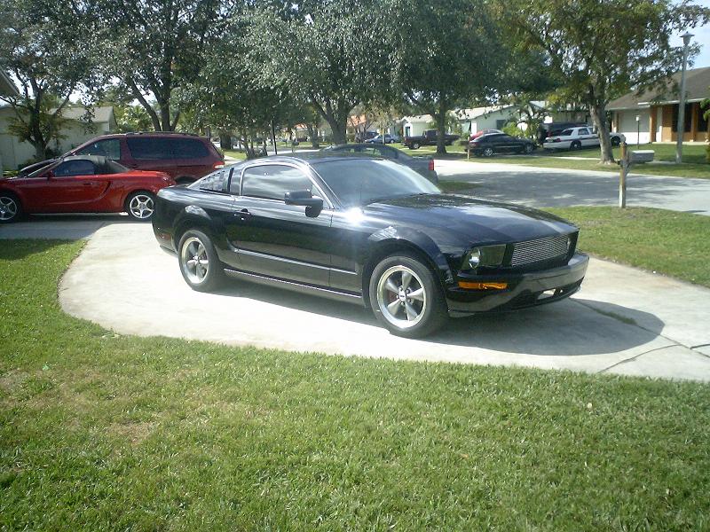

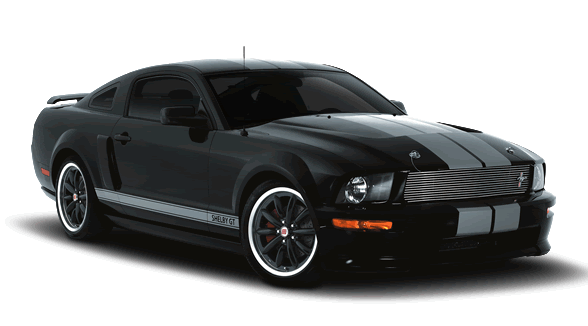

im debating on getting the cs6 hood because it has got to be the coolest piece ever made... do you think it is a wise investment or a waste of money?
i can get the hood for a fairly good price and free shipping

It would definitely look sharp. If you decide to do it, are you planning to add silver stripes and rear spoiler, maybe even the GT/CS front fascia, like the Shelby GT pictured? You know you won't be able to stop at just buying the hood!

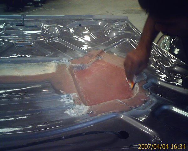

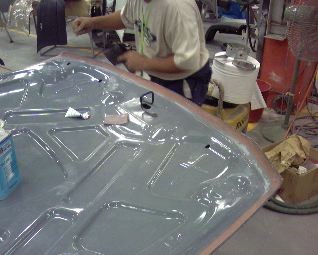

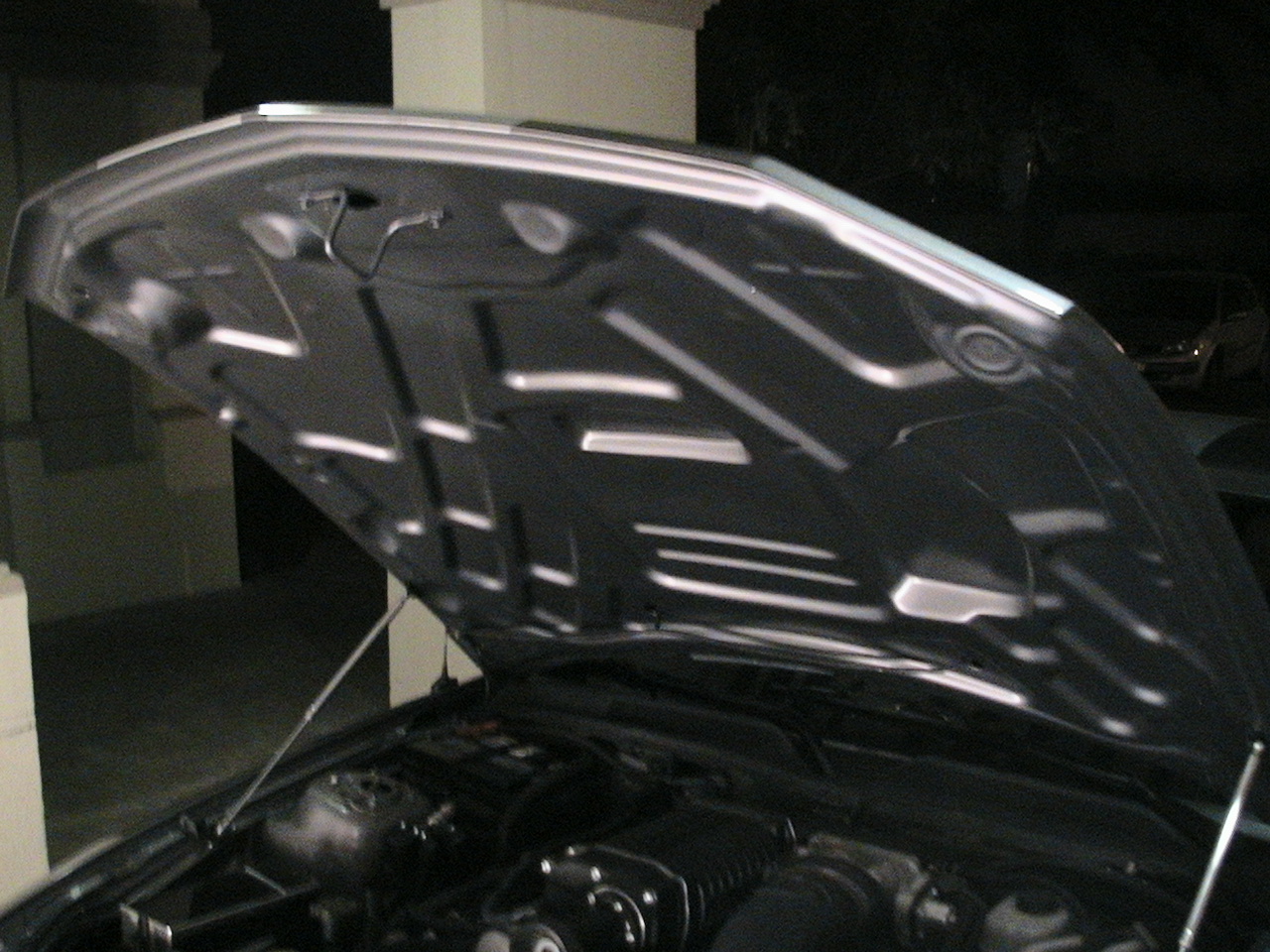

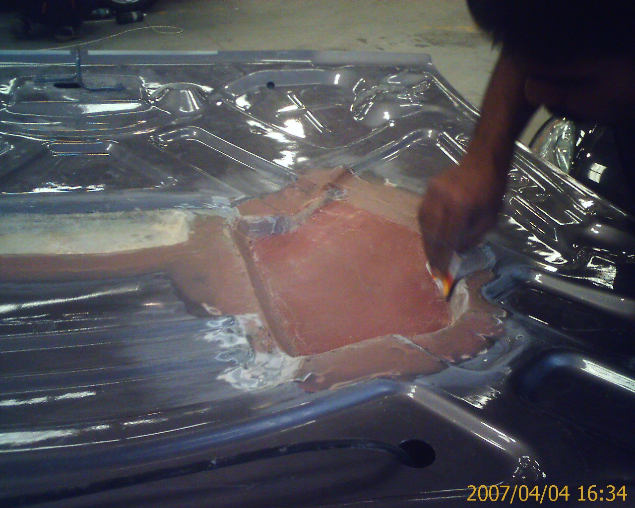

okay here's the scoop
i've got this hood since 7 months now, i love the look but hate the fit and finish.
the hood is double layered and the bottom layer is molded from the stock hood, however mine cured badly, and while the bottom layer looks just like the stock hood, it's way thicker and didn't clear many things underneath it.
the two layers weren't molded smoothly together, but instead you could see exactly where they both were glued, which i wasn't happy with and had to have it redone:
Attachment 23483

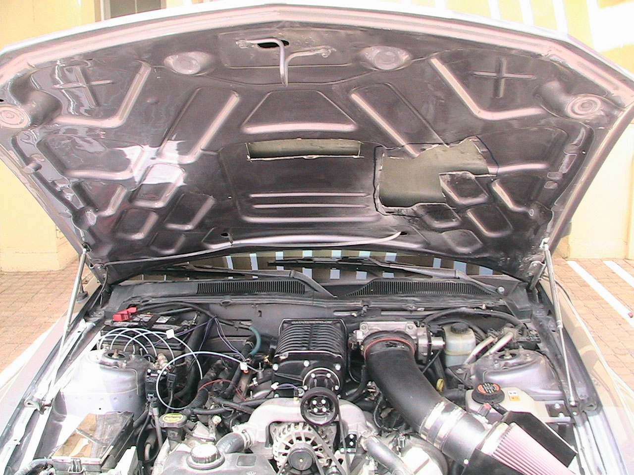

6 months later came the H.O whipple.. i finished the installation and wanted to take her for the first blown spin.
well.. darn hood won't close and i had to cut it up!
Attachment 23484
new fiberglass resin on, and hardner is being laid out
Attachment 23485

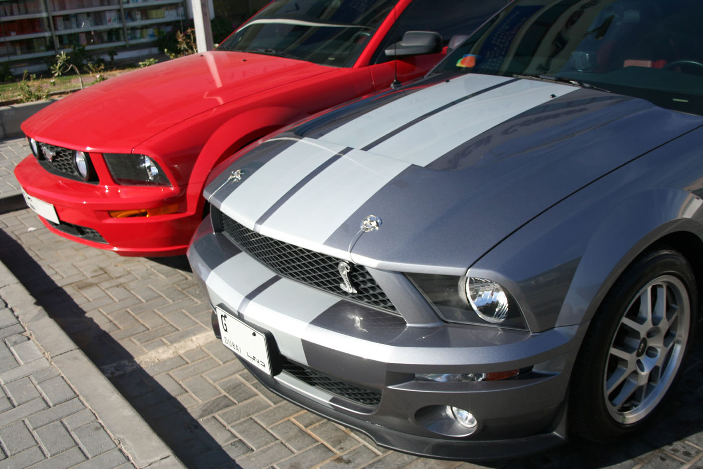

i still love the hood.. and won't trade it for anything except perhaps the GT500KR hood if it comes out
although mine took a lot of time and effort to make it work, i believe i was unlucky with a bad piece as nobody else had as many problems with their CS6 hood.
as for making it functional.. seeing all the work i've already done above, you'd probably be wondering why i haven't done it.
well i decided to go an alternative path, and mess with my cowl vent screens rather than with the hood.. still in the planning phase
final results ?
Attachment 23486
Attachment 23487
