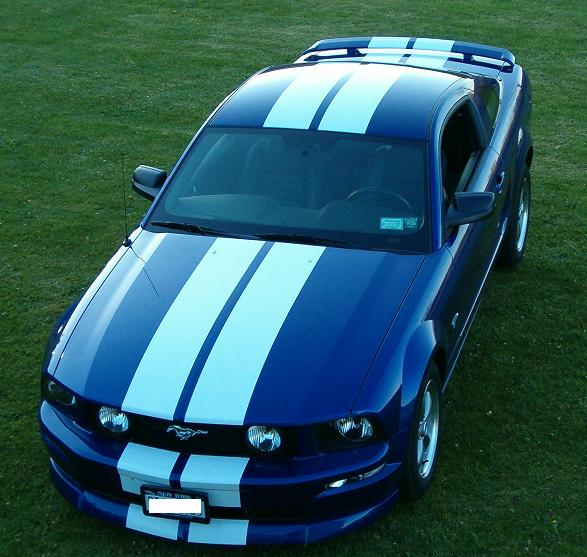

I'll echo what other people said. I used the 1.5" tape and spaced the stripes off of it. If you use 2" tape, it will be difficult to keep the edges from overlaping the tape. Also, do it on a warm day when the vinyl is flexible. Finally, it will take a while for any small air bubbles to work themselves out (a month or two), so don't be impatient.
Attached Thumbnails Calling all DIY vinyl stripe installers!!-body4_small.jpg

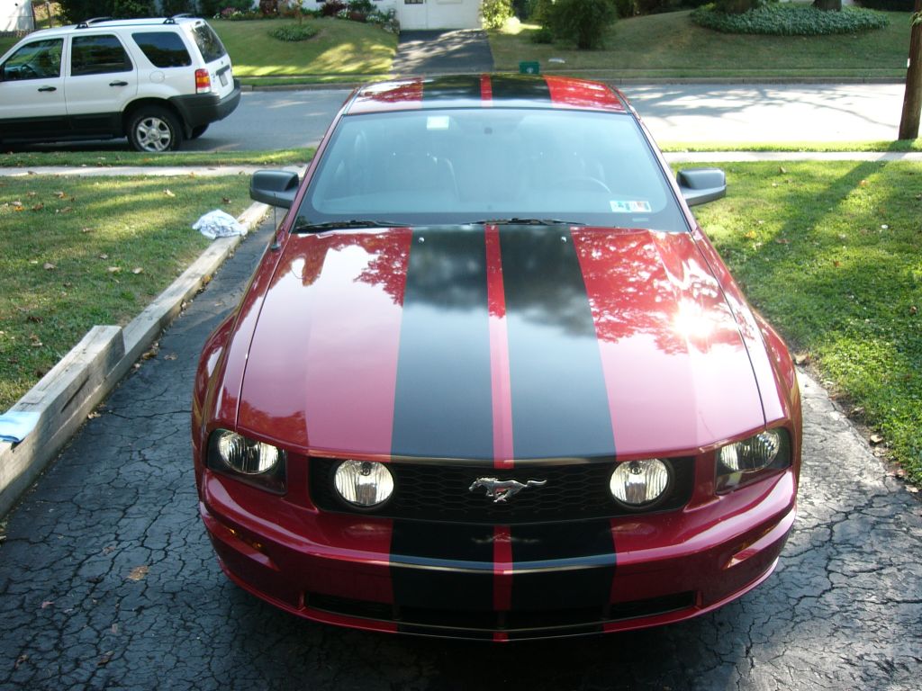

Ok, got both side stripes installed. My stripes are from BSM too, only I had my own lettering cut into it. They say "S197 GT" to match my license plate. I originally ordered a side kit that said "G.T. 350" but I decided against putting it on. Side note: that kit (in slate metallic color) is now for sale.........
I'm happy with how it turned out. If it ever stops raining here, I'll take pix and post them. For now, I probably won't start on the main body kit until next weekend, 'cause I'll be traveling alot this week for work.

Originally Posted by S197 GT
I have to see the "S197 GT" side stripes. I was thinking of doing that too!
Here's a decent pic from inside my garage. It's been raining since Wednesday and its supposed to keep it up past Tuesday (!) so I nice pic outside will have to wait.
Thanks.
Tom
