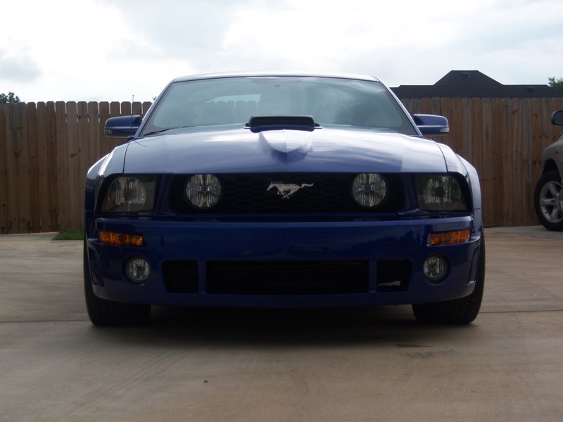

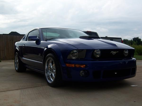

Sorry it has taken a little while but here our two pics of the new mirrors installed.

Nice. A very subtle mod. I like the lower fogs too.
Old Jul 28, 2008 | 07:29 PM
Shotokan1509's Avatar
Joined: June 22, 2006
Posts: 1,031
From: CT
Car looks real nice in general. I really like the Cervini B2 front end.
Old Jul 29, 2008 | 04:06 PM
mustang95's Avatar
Joined: May 3, 2006
Posts: 51
Thanks for the comments. Yeah, I liked the mirrors because you keep basically the same as stock except they have the lenses in the bottom.
