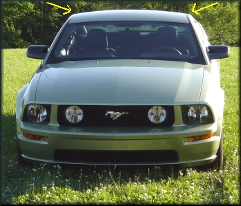

The two black lines on the roof are not very noticeable on some of the darker cars, however on my Legend Lime it is kind of distracting. I was thinking of checking out having them painted to match the car. Has anyone else tried this?

It wouldn't be a problem at all to paint to match. They are just flat black aluminum strips. But you are still gonna have the black rubber around the edges that can't be painted (or shouldn't be more like it)

Dane, have you seen the 05 stang? They are not black aluminum. They are rubber. I checked mine out after first seeing this post. I guess I shouldn't say they are not aluminum, I am sure they are, however, they are coated with what is almost a rubber substance. I can't see paint being able to stick to that.

I have seen an '05....I happen to own one and I happen to own a body shop and I have also happened to take mine off to repaint the car. They are aluminum...yes coated with black (more like rubber than paint is true) butno problem to scuff and paint (making sure to mask off the rubber flaps on the edges tho) As long as the rubber isn't flexing a major amount it will be fine. But if you paint your's to match the lime.....you will still have the two black flaps along the side showing....so is it worth it??? I dunno it's up to you. Attached is a pic front and back of mine
