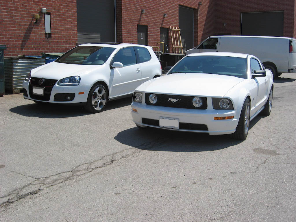

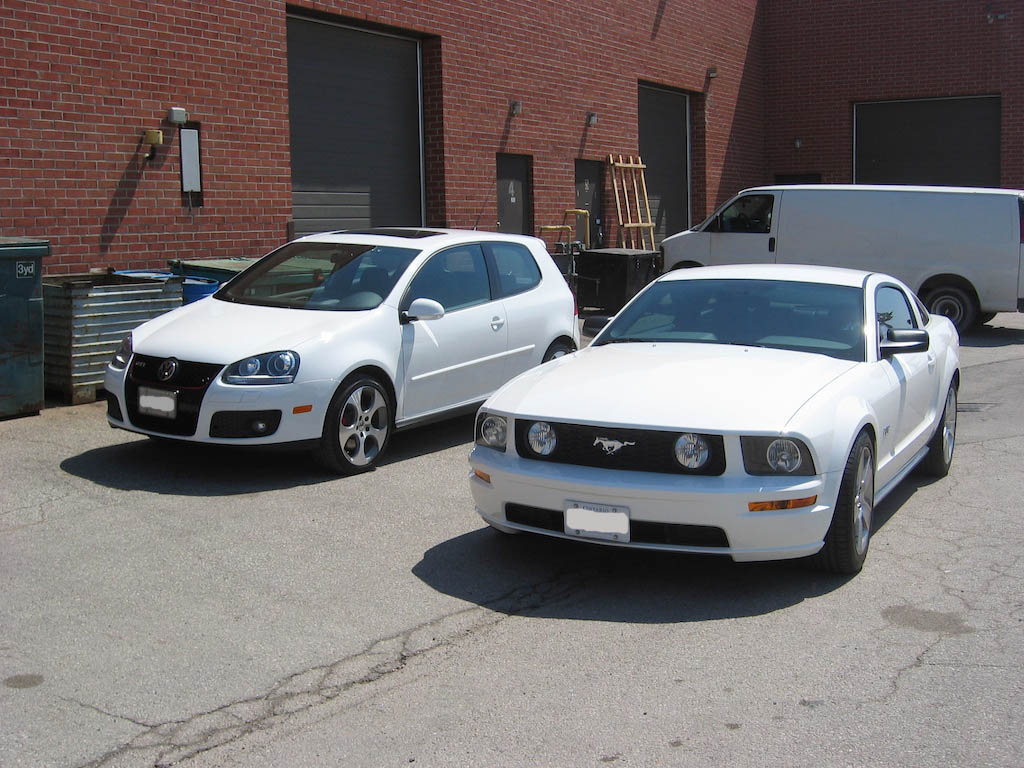

Here are some pics of mine w/1" spacers on the front wheels.
It looks ok, but it also makes the rears really look like they need them. I am considering putting 1/2" up front, and moving the 1" to the rear for a more even look, considering it turned out that I didn't need the full 1" space for the GT500 brakes, more like <10mm.

Thanks guys! I'm glad to see Krissy was able to clear the Brembos with fanblades! I'm also glad to see that I might be able to get away with less than 1". I'll start with 1" then if space allows I can start milling them down.

If you can slip 2 business cards between the wheel and the caliper, its plenty of clearance.
You can get the GT500 kit in red??
The fanblades look good like that, totally 'stuffed' full of brake

With 25mm spacers (1") I measured at the shop with their digital measuring...thingy...and had 18mm left of gap between the caliper and rim, so truthfully you only need about 8mm or so of spacing for the fanblades to fit. I round that up to 12.5mm, or 1/2" and you'd be set - since it's easier to find a 1/2" spacer for Mustangs then, say, 9mm.
No, GT500 brakes come in black, I painted them: http://forums.bradbarnett.net/showthread.php?t=64176
