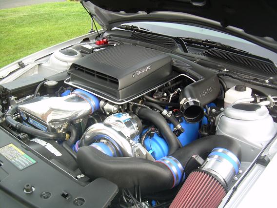

I used a Dremel with a plastic cutting wheel to make my cuts, and went outside the lip and cut from the bottom. You'll need to trim some of the shroud away as you cut.
Then I used chrome door edge molding, but there are plenty of options. The Cobra Jet emblems were from the Paddock. I could care less what anyone thinks about a Cobra Jet emblem on my Shaker. The car makes 470 whp, so it's doing the name proud. Shame on Ford for not giving this motor a name.
Anyway - I will have custom tubing dome to get it to flow right into the Vortech.

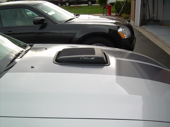

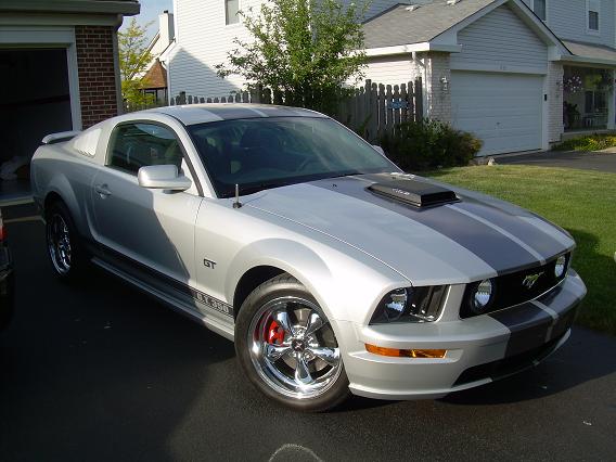

Installed it today guys. Here are the pics.

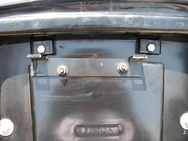

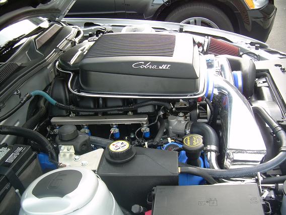

Originally Posted by nonstopred
hey, does it still mount correctly without all the extra stuff??
Yes because you still use the two throttle body bolts to hold the front and the ball and stud for the rear. Hear's some pics for reference.
Front mounting bracket.
Rear ball/stud.

You just take a dremel to the shroud. No you have to buy the entire setup because even with everything modified you still have to have part of the shroud for it to mount to your engine bay.The scoop alone would do you no good unless you were planning to just glue on to the top of your hood.

The shroud is just trimmed down, you'll still have to buy the complete kit. Part of the shroud is where the front bracket & rear mounting ball is attached.
