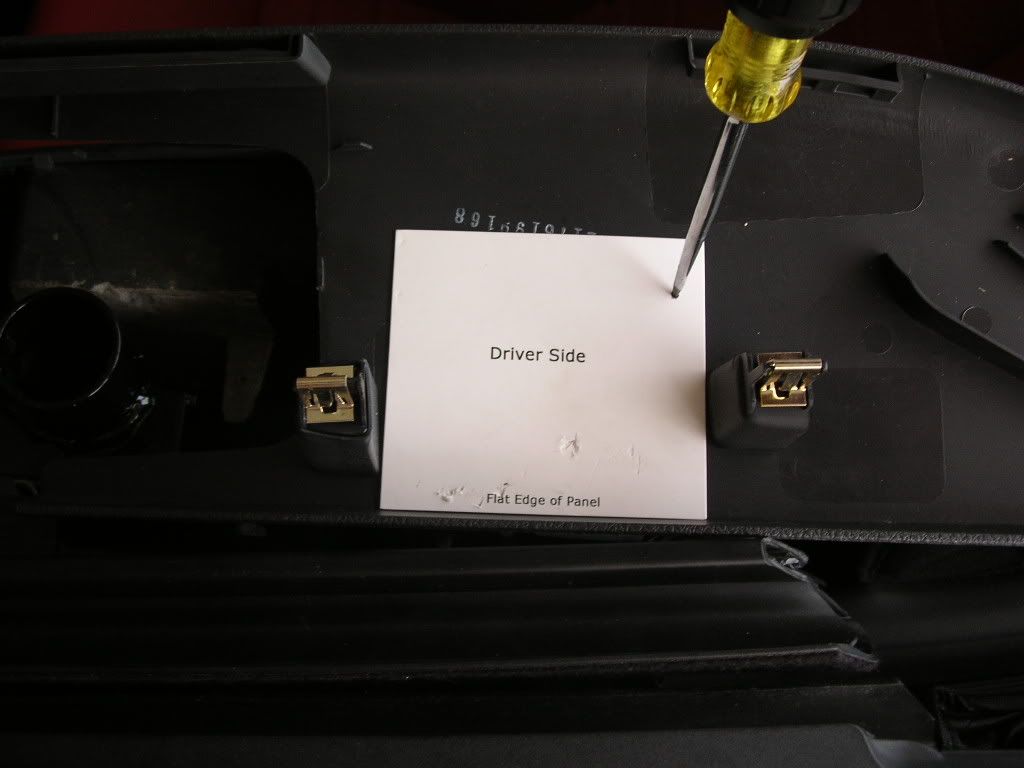

This supplied template shows exactly where to mark the center of the hole that needs to be cut into the panel removed in step #1. I used an awl to make the mark. I then drilled the hole out with a small drill bit.
I noticed that this roll of electrical tape had the same inside diameter of the hole that needed to be cut into the panel: 1 1/4". I layed the roll of tape on the panel, putting the small hole in the center and marked the bigger hole with a Sharpie.
The instructions say to use a hole saw, but since I didn't have a 1 1/4" hole saw, I just used a dremel to enlarge the hole to the proper size. Here is the panel snapped back into place with the hole the perfect size for the bar to go through into the receiver. Not too shabby, if I do say so myself! The hole only needs to be the size of the inside diameter of the tube on the mounting bracket.

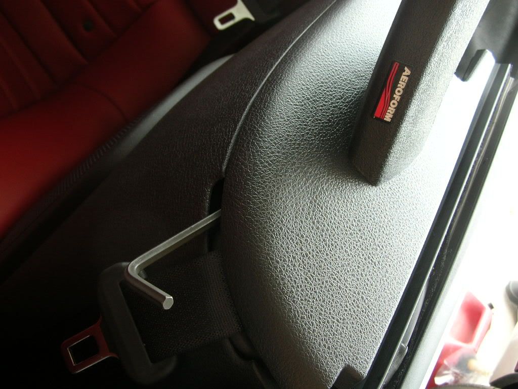

Finally, you can lay the bar into place. I did it myself, but it may be easier with a helper. The suppled allen wrench fits through the seat belt opening to tighten the set screw that securely holds the Sport Bar into place. Push down on the bar slightly to get the best possible look at the area where it meets the trim panel. Don't push down too much or it could distort the edge of the foam facing outward. There's not much leverage, but you can use an adjustable wrench to turn the allen wrench and really get a good bite on the bar with the set screw.
The finished product! Looks awesome and it's very easy to install.
