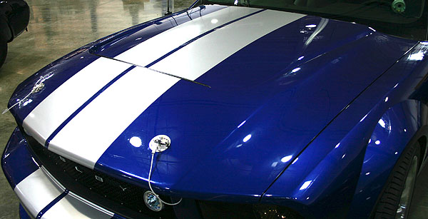

First I'm getting the shelby cs6/gth hood. Basically I need to know what I need part wise for this hood other then the hood itself. Do I need new hood lifts? Or any other parts?

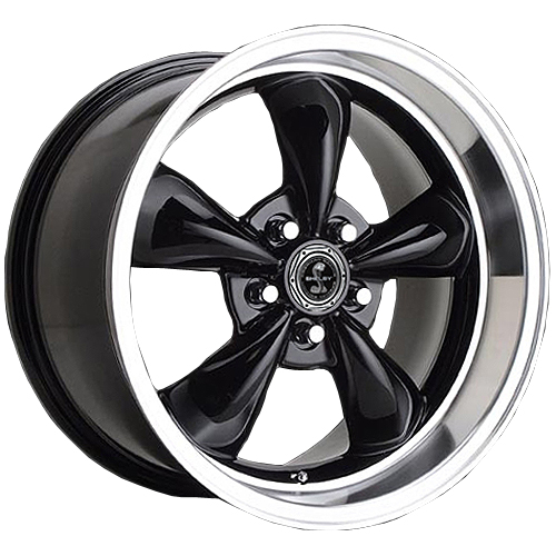

Second I'm getting new wheels the wheels I am choosing are these:
http://www.americanracing.com/wheels/details.asp?parent=239&wheelid=240&name=Torq-Thrust%20M%20Shelby%20(Black)&style=105MSB&desc=1-piece%20painted%20alloy&section=V
Part No.
Size
Offset
Backside
Bolt Circle
Note
105MS8166B 18x10 45 7 1/4 5x4 1/2
105MS8165B 18x10 24 6 7/16 5x4 1/2
These are the torque thrust shelby vintage wheels in black 18x10. Basically I'm wondering what offset I need. Also I want the widest tires possible and I need to know exactly what this is. I really wanted to atleast get some 305's so let me know what yall think would fit. And also what size I should put on the front if I have 305's on the back.

i got the Shelby CS6 hood, and used it with the stock prop for a month, then put the RedLine quicklift elite struts..
Furthermore, if you wanna fit the Shelby CS6 hood pins where they're supposed to go, you could either get a Shelby CS6 radiator cover from Shelby, or cut your own cover to clear the pins.. no biggy.
finally, regarding the tires.. i'm running on the SVT GT500 18x9.5" rims, with Michellin Pilot Sport A/S 255/45ZR18 up front, and 285/40ZR18 out back.
i wouldn't go wider than 255 or 265 MAX up front.
Ok as for the hood did it work ok with the stock prop? Did you have any problems that made you switch to the redline quick lift struts?
As for the hood pins I think I might go with the radiator cover from shelby just to make this as simple as possible

First of all let me say your a freaking savior that is pretty much all I needed to know and you not only explained it you even told me point blank. I love you...
Now back to reality that sounds great on the wheels as to my weather I'm in texas and most of my driving is Austin/San Antonio/Houston so it's pretty much always hot but sometimes (Houston) it's really humid. I was thinking Nitto's for the tires if this works basically because I tend to like their tread patterns (i'm stupid). Hopefully they aren't more expensive though. I think that answered most of my questions so thanks a ton if I have anything else I will let you know.
Part No. Size Offset Backside Bolt Circle Note
O i thought of one more question which of these rims do I actually want 24 or 45 offset? and does the other stuff make any diff? Thanks!

Still need a response on the offset ^^ but now i have one other question. What are the stripe dimensions of the shelby gt/gth/gt500 and is there something i could do that would look similar if it's too complicated??

i believe they are 10.5" wide, with a 1.5" gap all along
