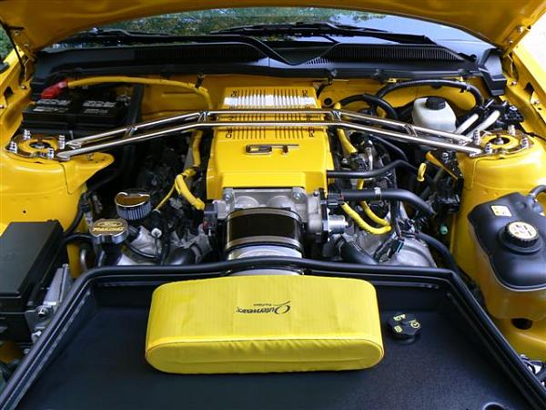

Has anyone found a fog lamp that will fit in the stock lower grille sides yet? If so please provide info.
I want to relocate the GT fog lamps that are in the front grille down to the lower grille. Fog lamps should be as close to the pavement as possible for effective use anyway.
I want to relocate the fog lamps on the GT to provide better air flow to the WMS ram air setup that I'm using.
Thanks for the input.

Just curious, it seems the ram air comes in above the fog light positioning so I am wondering how you figure this will help?
As far as repositioning to the lower grill the only ones I have seen are done with new front bumpers with a bigger lower grill. Good luck with that though. Post pics of whatever you come up with.

The GT stock grille will remain. Behind the fog lamp holes a black mesh screen will be inserted. From the back of each fog lamp opening there will be placed a plastic fitting, from each fitting a flexible hose will be ran to another plastic fitting that has been attached to each one of the 1-1/2" x 7" openings on the WMS ram air intake.
Since the WMS ram air hood is sealed to the inside of the hood when it is closed this mod will help to create a more positive air flow pressure in that area when the car is moving.
Now back to the original post............any fog lamps available that will fit into the stock lower grille sides?
Thanks for your help

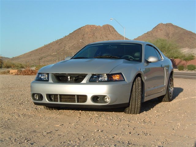

....Fog lamps should be as close to the pavement as possible for effective use anyway.
I totally agree. In my opinion, and I know I'm a very small minority here, I dislike the GT fog lamps. I know Ford put them next to the headlamps and made them HUGE to pay tribute to the '69 front end with quad lamps. I believe these set the world record for size on a fog lamp! Did Ford realize that "old schoolers" like myself assume that an oncoming GT with fog lamps on look like high-beams? Fog lamps should be low, not level with the headlamps.... Well, at least the GT500's fog lamps are in the "correct" position.... as well as my '03 Cobra....
