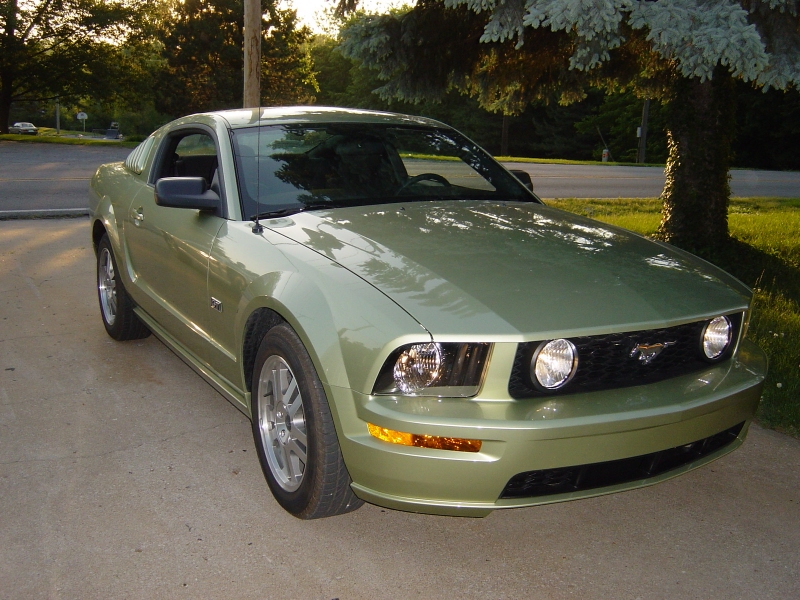

There have been a couple of threads on this posted here. If you look back through the previous pages you should find them ... I assume those pics are your first and latest

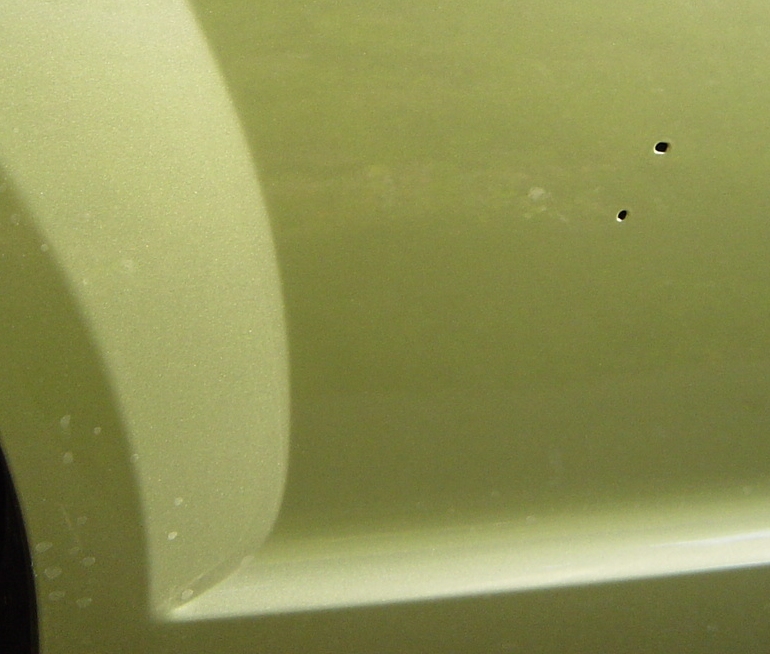

Thanks for the help. Finished Two mods today. Side Vents and the GT Emblems.
Next up are the chrome tailight mod (have parts just not time yet)
and then the Fake Gas Cap on the tail....
Also looking for a coral big enough to fit around my grill horse. This is fun.
Oh, and for those wondering, these are what the holes look like on the fender when you remove the original GT emblems.
