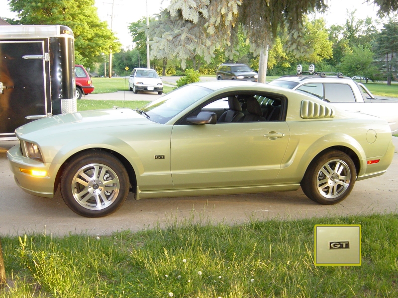

I'm modding my '05 to look more like my '68.
So far I've added chrome molding on the tailights, 68 GT side emblems, louvers, and I'm working on the rear emblem.

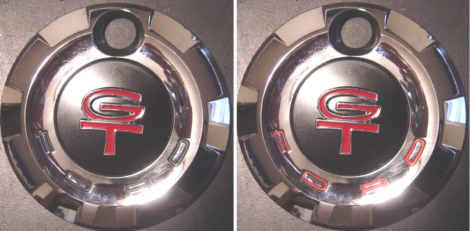

So my question is, do you think I should put the FORD letters Red or leave them Black?

First, I have not found a C-Stripe that looks really correct but am looking. They make a C-Stripe that is basically upside down from the original. The top line is shorter than the bottom as appossed to in 1968. I really want that, but because FORD placed the door handles where they did, and enlarged the wheel area for the bigger wheels, a C-Stripe may be difficult. I'll probably have to have them painted on. Still looking at that.
How I Made the Rear Emblem Retro 68.
1) Purchased another emblem off of Ebay for around $25.
2) Taped off the center area and sanded, primed, blacked out, and clearcoated the center.
3) Back to Ebay, purchased a red 1968 Emblem for a pop-open gas tank.
4) Placed the 68 emblem and found center of the blacked out emblem.
5) GT tag has 3 little "nubs". I marked them on the blacked out emblem.
6) Found an appropriate width drill bit that wasn't too big, and would make the GT "nubs" a tight forced fit. Drilled the three holes.
7) Put a little bit of plastic/pvc glue in the three holes, pressed the GT emblem in place, then let it dry.
I still havn't installed it on the car. In some other threads I had asked if the 05 rear emblem was bolted on or just glued. I have been told by several people that it is only only with double sided tape. However my newly modded one has two "nubs" on the back with fasteners. Yesterday, before the big Midwest Mustang Show here locally, I got a flashlight out and looked at the inside of my trunk, and could just barely see that it is indeed attached with with the two, "nubs". Only problem is there is no way to get to it. So I'm planning on buying the 2005 Mustang DVD off my favorite, Ebay and see if there is a special tool for getting in between the two pieces of metal that makes the trunk.

The emblem on the trunk is not actually "attached" by those nubs, just aligned with them. The emblem you modified, did it have the double sided backing on it? If so, you just have to basically "peel" the original emblem off, fiddle with stuff to get the sticky stuff off the trunk (this could take a long time to get absolutely clean), and just push the new emblem on in its place.
