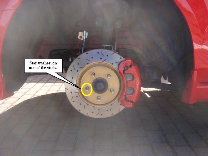

Just in case you haven't heard about it before, another contibuting factor could be the small locking washer thing that is on one of the studs of each rotor. I removed mine, as to eliminate any possibility of causing a vibration. Just a thought, if all else fails. Pic is attached showing where the washer is located.

for those that have bought aftermarket wheels, be sure to remove the tab as noted above that is on one of the wheel studs from the factory. use a pair of needle nose pliars to pull off the metal tab. this is put on at the factory to hold the brake disc in place while on the assembly line. the factory wheels have the clearance around the stud for it not to interfere, but most aftermarket wheels do not.

2: jack up the wheel in question and spin it by hand. look for run-out. if the wheel wobbles, its possible you did not remove the factory tab or the wheel itself is bent or out of round.

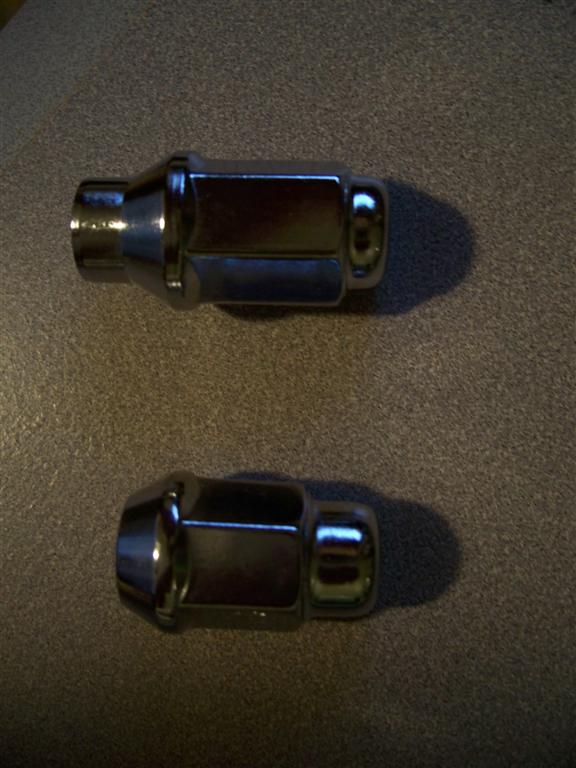

I installed the new lug nuts and it made no difference. The lugs are lug centric, meaning they are fitted to fit inside the lug opening so they tighten what looks to be all the way to the hub or close.

BTW, here is what my old vs new lug nuts look like ... as you can see, the newer lug extends well down into the lug opening of the wheel vs the old being a conical seat.
