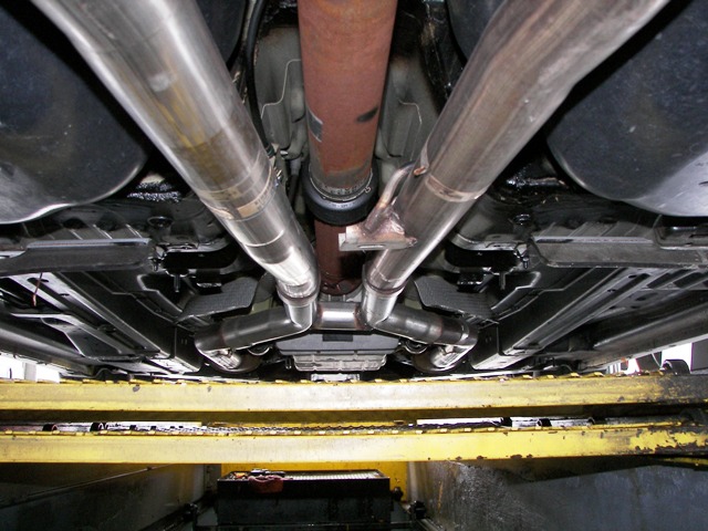

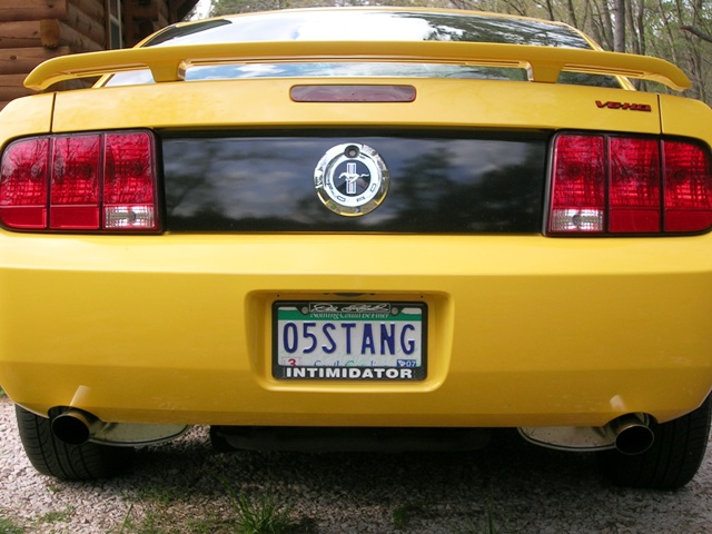

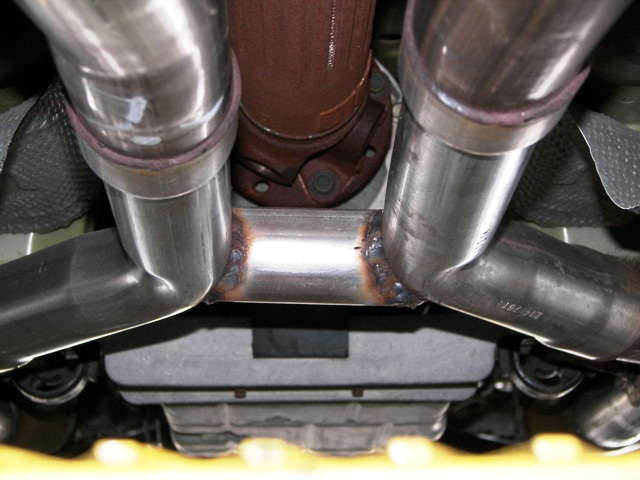

My set up was right around $200. This includes GT Mufflers, GT Midpipe, Ford hangers and labor. Be sure to use the GT midpipe as it is stainless steel and already has the correct mandrel bend. The ford hangers make it an easy job. There was some welding for the H. If you use this method, everything will fit and line up correctly.

racer, that looks pretty good. Where they made the Hpipe, those pipes dont look mandrel bent, the actually almost look kinked. Is it the lighting or what
The mandrel bend I referred to was in the GT midpipe where the mandrel bend slips over the rear wheelwell. The portion, including the H from the header flange to the midpipes is all custom.that portion was formed but not on a mandrel. As a consequence it's a sharper bend. Does it affect the overall scavenging? I have not a clue. All I know is that it sounds good and gets the job done and that's good enough for me. I haven't looked under a GT - do you know if the front H section is mandrel bent?
