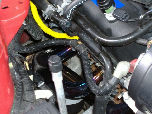

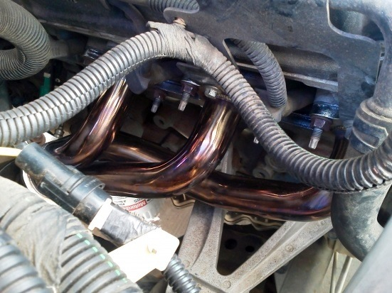

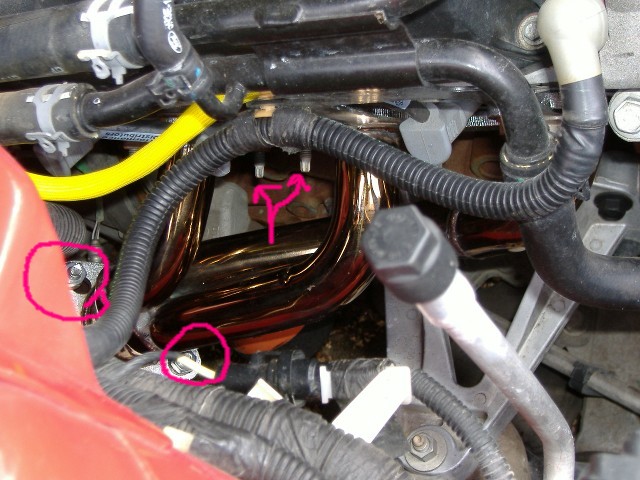

the one drawback to trying to remove the head studs is if you break one trying to remove them you might have a job on your hands. the little torx ends break real easy. some guys have double nutted them to remove them. theres really no point to go through all that. you will have to use new bolts for the cats.
the head studs dont rust, just the nuts do. i re used all mine too. i might replace the nuts someday with new stainless. my e bay headers have been on for 4 years, $100, no issues at all.( and i still havent replaced those darn nuts)
the stainless headers dont look good after a few years either. ive been running a demon coil and live wires for 4-5 years too. at that time it was the only aftermarket coil. i think i would go with the accel myself, but what i have has been great. those items your looking at will not greatly increase your performance but are decent upgrades. mod addiction can be alot of fun
