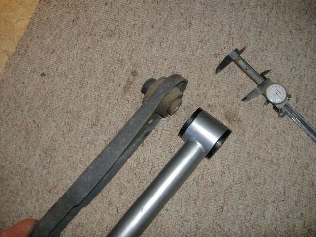

i got my chrome moly street control arms on yesterday. the lowers were pretty easy to do and really look good compared to the factory stamped sheetmetal parts. the rubber on the oem parts looked pretty weak and rust had started to set in, as i have alot of miles on the car now. i didnt really have any wheel hop issues though.

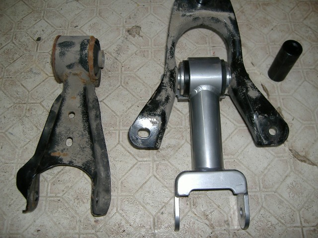

getting the bracket off for the upper arm was a pain though. have to pull the back seat out to get to one bolt, and lower the gas tank to get the bracket off the car as theres not enough room to work the control arm bolt under the body channel. doing it laying on the ground made it tougher too.
i only went for a short test drive last night, gave it one good hole-shot and it seemed like it put some power down to the 3.73 gears. a little more testing is needed to comment on the ride or handling.

Attached Thumbnails installed upr rear control arms on the V6-ca-lowers.jpg   installed upr rear control arms on the V6-ca-uppers.jpg
