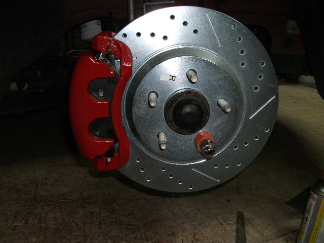

yep you dont even have to remove the calipers from the car, just hang it with a wire to the side, i set mine on a tiny jackstand, swap your brackets and rotors and your golden. yep, great time for paint. since your gonna pull your pads for painting, clean em up and make sure to put some high temp grease on the pad ears where they sit into the tin clips. i was real happy with the upgrade, but not long after i did that, i needed rear rotors. you dont find those cheap like the frts, so i swapped out the rotors anyway with these shiny zink plated ones.

That kit will work - if you look at the picture of the calipers you can see the brackets are attached. Just remove the bracket from the caliper and swap brackets and rotors and you are done.
