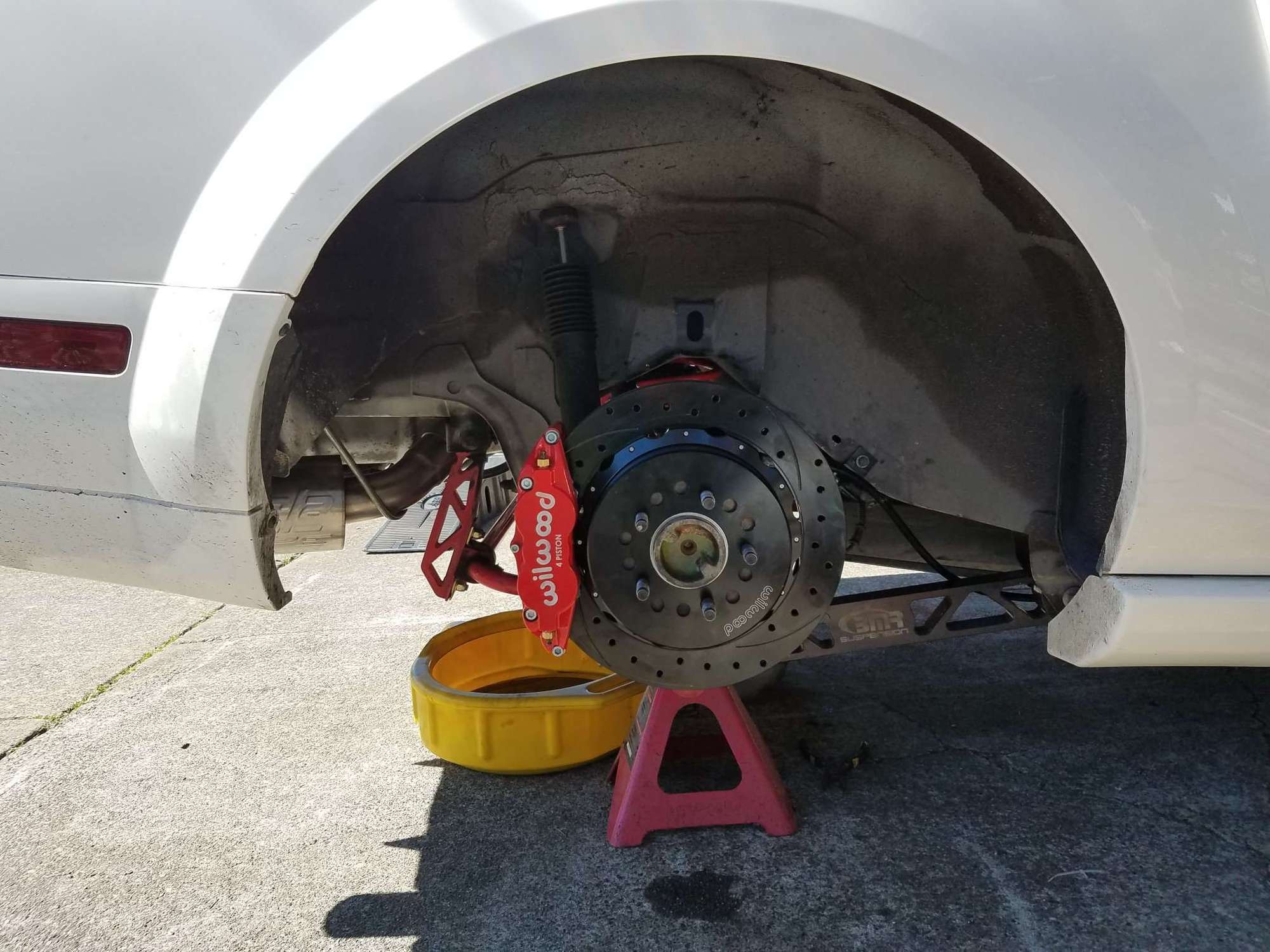

Yup and never thought I could enjoy stopping as much as I do now. Very expensive brakes but you definitely can feel the quality. Bit of a pain to install the rears though. I wasn't prepared for having to remove the rear axles to get the new bracket installed. Although it did give me reason to order a new diff cover since the OEM cover was off. Has some issues with the quality of the studs that hold the rear calipers on. These are not meant to be taken on and off very many times. Poor design as you virtually have to do this in order to get the spacers correct. Both sides resulted in a stripped out stud that became an issue. I was able to get them removed and located replacement studs at the local hardware store. The thin-walled loc nut was another issue however. I got lucky and had perfect spacers that allowed me to use a traditional loc-nut on both sides. Something to consider Wilwood!
Overall great choice in brakes and you wont be disappointed!
