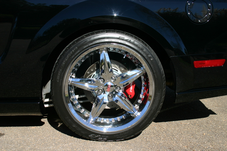

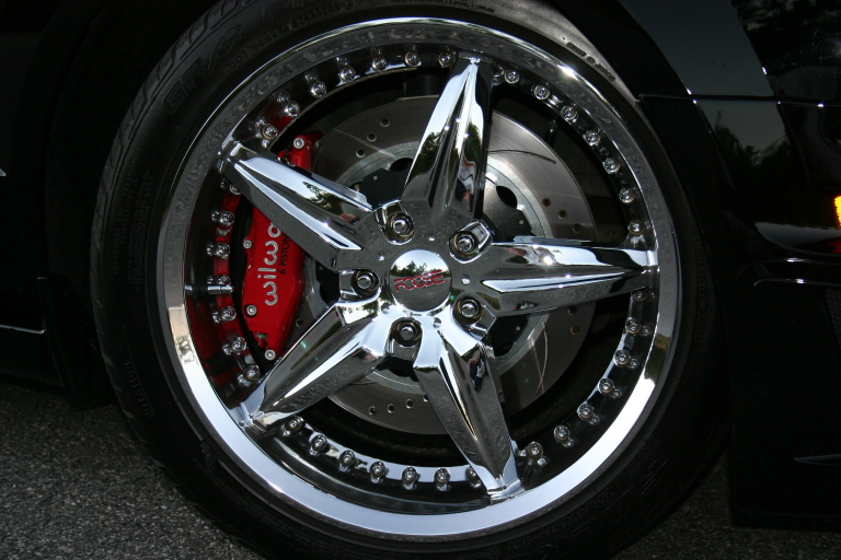

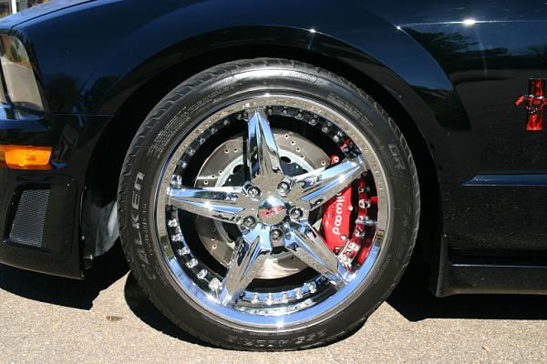

superlight 6 piston calipers w/ 14 inch 2 piece slotted and cross drilled rotors up front , 4 piston calipers on rear w/ 12.9 inch slotted and crossdrilled rotors on rear........their unreal....its stops like it hits a brick wall
Heres some installed pics ( ohhh the wheels and tires are for sale also....with some very cool freebies thrown in ....pm or email me at hireman356@aol.com for more info.

yep they use small internal drums for the emergency brake with shoes....you have to replace the factory parking brake cable from the tee backwards...I use a slick lokar cable kit....works awesome....heres the part numbers
SUPERLITE 6 BIG BRAKE FRONT HAT KIT
PRO STREET APPLICATION, 14.00†DIAMETER VENTED ROTOR
2005 - PRESENT MUSTANG (5 LUG, STOCK OFFSET)
PART NUMBER 140-9110
DYNALITE PRO SERIES REAR PARKING BRAKE KIT
WITH 12.19†DIAMETER VENTED ROTOR (2.66 OFFSET)
2005 - PRESENT MUSTANG 8.8 (5 LUG)
PART NUMBER 140-9228

I think the rears would clear factory 17 inch wheels ...the 15 bogarts I'm not so sure of...I know that anything smaller than 19's on the front probably would not clear....you can see how much room I have for them on the front pics

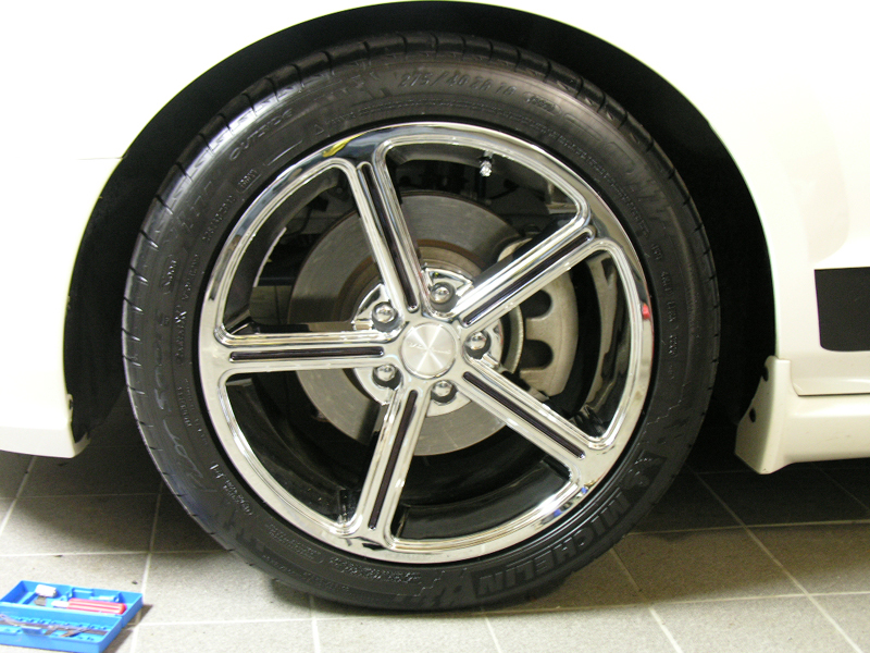

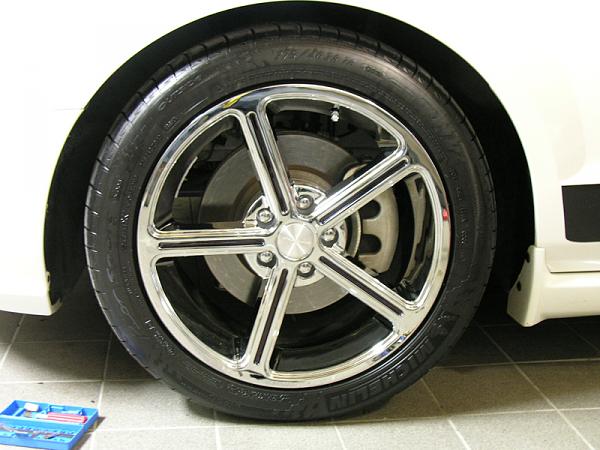

OK I thought it was the superlight rear kit with the 2pc rotors
