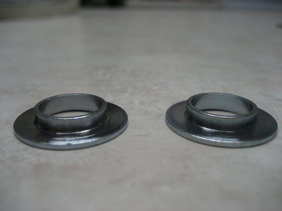

Jon i just read soemthing else that may be of interest to you. This is a excerpt from Steeda's website.
"""Stepped Spacer Details
This spacer is designed to fix the problem with the OEM upper link. At the attachment point for the upper link to the chassis mount Ford uses a 14mm bolt, but the opening in the mount is 16mm. This is not typically a problem with the OEM mount as it uses a soft hydra mount bushing to soften this. But once an aftermarket upper is installed with a urethane bushing can transmit this noise or clunk. This space can be installed with all aftermarket upper that still use a 14mm bolt. The stepped spacer takes up the slop and eliminates all noise from the upper. Note, it does work with aftermarket chassis mounts with smaller then 16mm bolt holes."""
And here is the lionk to the part:
http://www.steeda.com/products/tubul...r_3rd_link.php

Thanks for the link Richard. It's certainly worth a try. Gotta wait a bit though as I won't have access to a lift for a couple weeks. Kinda stinks but will have to put up with the noise until then.

Whoa...I'll bet that is my problem. Nice find!

I ordered from Steeda this morning. If it gets here Friday, I will install this weekend. I have several thousand on mine! Did you replace the bolt also?

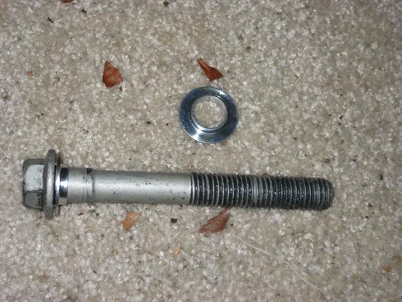

Installed
Well, I installed the stepper washers. Honestly, I don't think it made a difference, in my case. I heard a nice clank when I first drove it after re-install (haven't heard that noise in months!) and I still seem to hear some clunking over bumps in the rear. I think it has to do with the jam nuts and the ends still wanting to twist on that UCA. The back jam nut was loose when I got under there to remove. Maybe that is why I hadn't heard the loud clank in a long time. Anyway, I will see if I still hear the clicking I do every morning when I park in the garage at work on Monday. To me, I thought the clicking was the clutch packs in the rear diff as I hear it when turning and going slowly, however, I didn't hear anything until I installed the upper.
