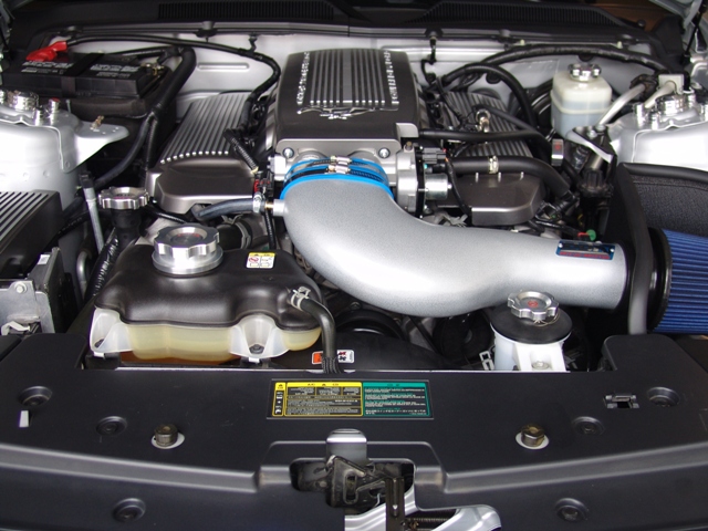

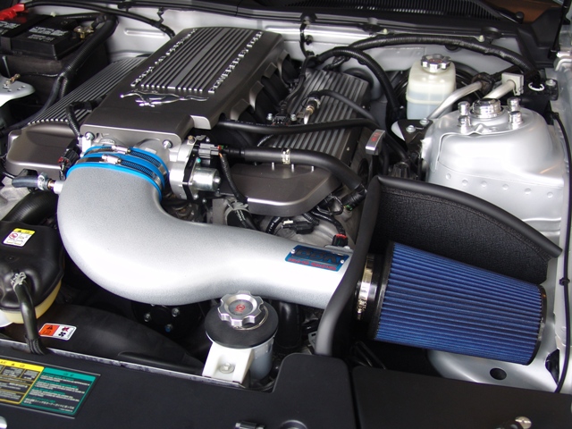

I'm happy to report the car is running perfectly with my new CAI and tunes. Here are a few shots of the installation. It's a great quality piece and very well engineered.
There's a polished version of this CAI available, I kind of wish I went with that option, although this finish matches my paint pretty well.
Tim
