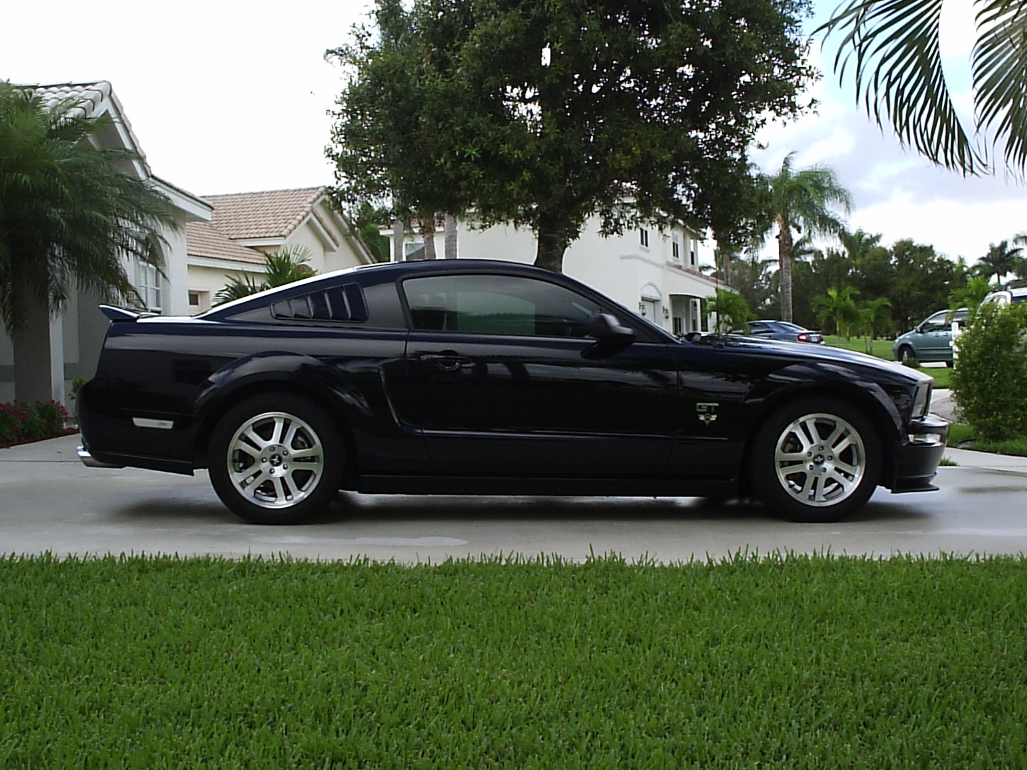

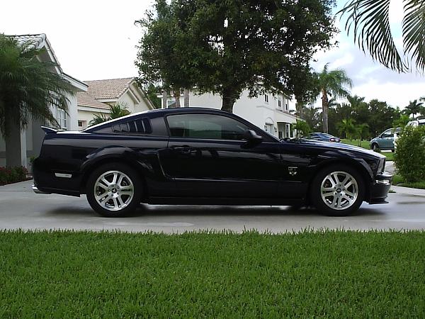

I have the Ultralites, dropped the front about 1" and the rear about 1 3/8", real happy with them, my cars a daily driver also and the ride is still as good as it was with the stock springs,
just lower and a bit firmer.

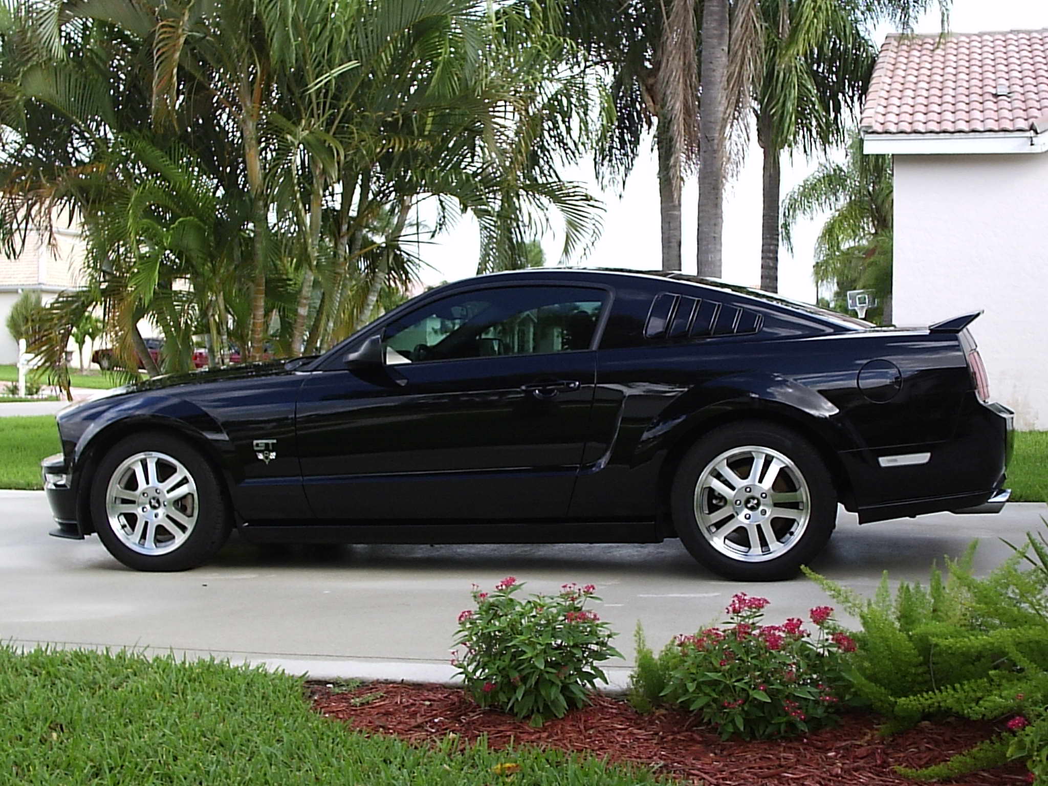

Here are the ultra lites on my '05. The tires are 275/40/18 all around (what steeda sells) so a little smaller than stock diameter, which I think makes the space between tire and fender look wider... especially in the back.
