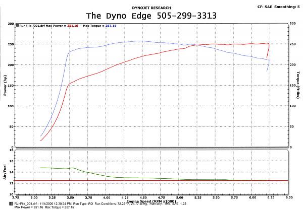

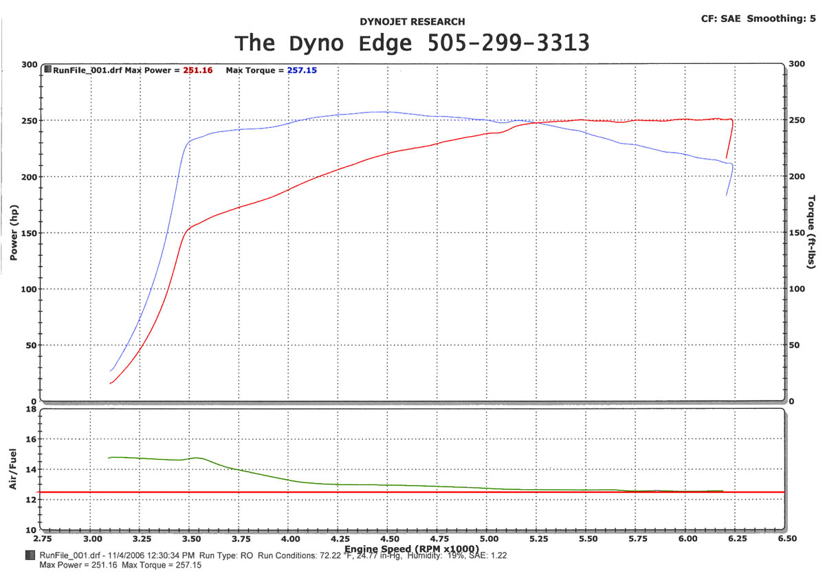

This is what I don't understand, my a/f clearly shows an increase towards lean upon initial WOT, and then settles down to 12.5. So how is this not correcting the air transfer function as you call it?
Attached Thumbnails Tuning is required for the so called tuneless intakes-05gtredfire-20dyno.jpg

This is what I don't understand, my a/f clearly shows an increase towards lean upon initial WOT, and then settles down to 12.5. So how is this not correcting the air transfer function?
Your a/f ratio isn't the same as that found on the other 5 intakes like yours. Therefore this shows that at best you may have a shot of the a/f being good but so far 5 out of 6 tested show lean. That's the three we tested in St. Louis and the 2 I've tested here. The best thing to do would be if you plan on running this intake without a tune then invest the money for a dyno check. Most run 3 pulls for $60-100. This would be cheap insurance and will give you your a/f results.
Did you do more then one dynorun on your car? What were the other runs?
Do you have the dynojet files for your runs? If not would you mind calling the shop and having them email them to you? Then you can compare them with out runs as I can send you the 2 I did before the dynoday and when I get the St. Louis dynoday files I can send you those too.

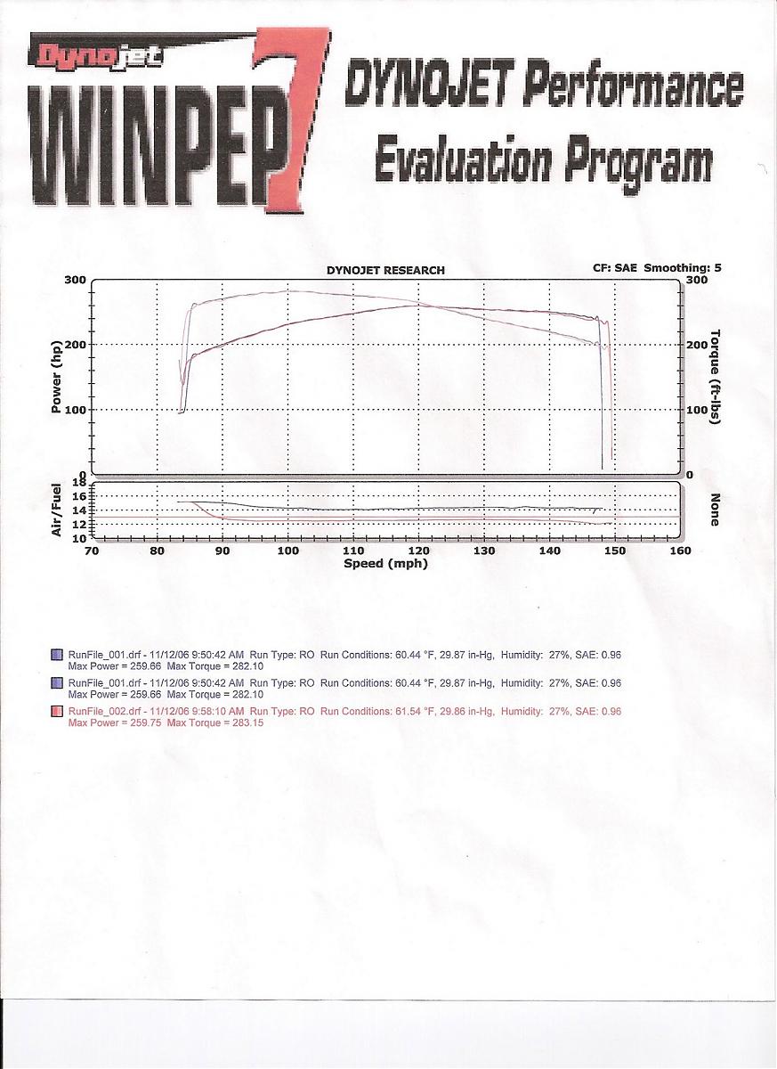

Heres my Dyno sheet!
Hope this helps some. If anyone wants it I will email to you, pm me if you want a copy. I cant resize it too well it seems.
Attached Thumbnails Tuning is required for the so called tuneless intakes-scan0005.jpg

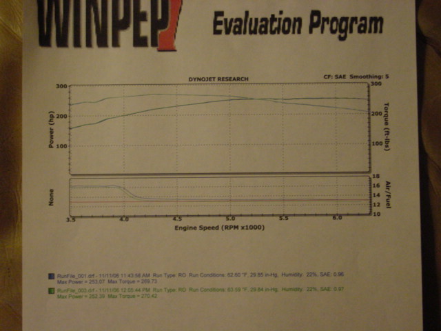

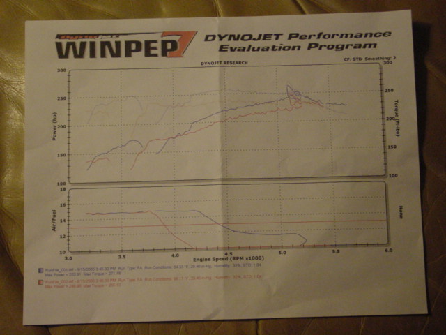

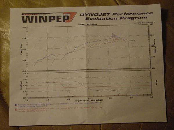

Here are two dyno runs, one was done Sept 15 at a local dyno. This was for a base run, come to find out the operator had it set on STD and not SAE, so there will be some differences there.
The 2ed one is the tune with Doug from Bamatunes on November 11th in St. Louis.
Currently the issue is with air flow, you can see the changes Doug made with the tune. also note the HP difference, took out the torque converter problem and smoothed out the roughness.
I am happy with what he did, well worth the money spent.
Which dyno would you like your car to be?
