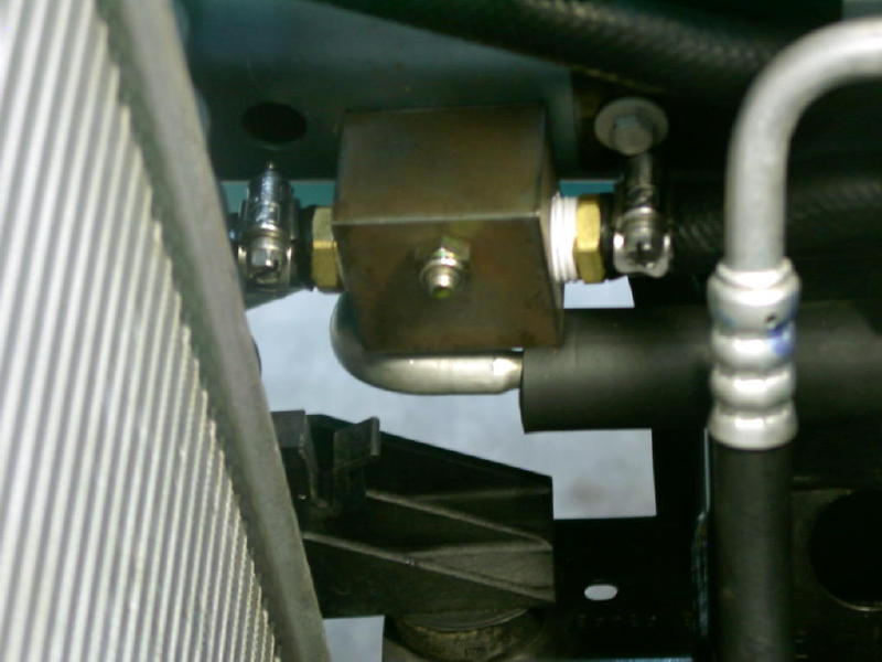

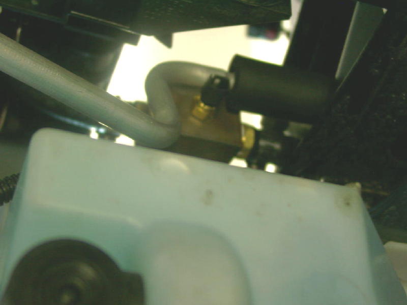

Install the sending unit in the lower hose going to the transmission oil cooler.
Attached Thumbnails transmission temperature gauge?-pdrm0846.jpg   transmission temperature gauge?-pdrm0845.jpg

Where did you get that block or that the one you made ?

I fabricated the block myself

The sender installation is a real PITA due to where it must be located to be accurate. I installed mine during my Saleen S/C install when the fan was out and the front fascia was off. I also suggest removing the windshield washer bottle to make access a little easier.
Just FYI - the block I fabricated, machined and tapped is a nice piece but not a necessity. This is actually the 3rd trans. temp gauge I have installed. The first 2 were very simple - (1) 1/2" NPT Tee, (2) 1/2" NPT x 1/2" barbed hose ends, (2) hose clamps and some thread sealant. The 1/2" x 1/8" NPT pipe bushing came with my Autometer Cobalt Electric Full Sweep gauge. Very simple yet effective. All plumbing parts were purchased from Home Depot. Crude but works just as well as the block.
One other item worth mentioning - use 2 pairs of needle nose vise grips to gently crimp the lower trans. cooler hose on each side of the tee you will install and you'll only loose about 2 oz. of trans. fluid.
