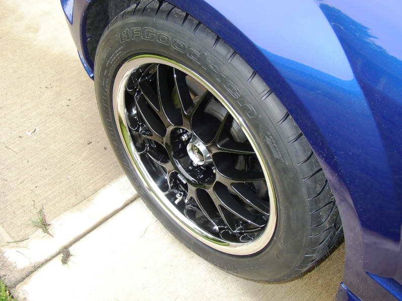

Just as an update, I did end up getting some Sport Max Racing wheels and bf goodrich tires.
I got 255/45/18 all around. 18x8.5 inch rims in front and 18x9.5 in the back. I ordered 18x8.5 all around but they came in staggered. I will just get some 285/40/18 in the rear the next time I buy tires.
I had another tread about this but I just wanted to post on this one as well.
The car was pretty dirty when I took these pics.
Attached Thumbnails Tire Size - Should I go with lower profile?-p10101661.jpg   Tire Size - Should I go with lower profile?-wheel2.jpg   Tire Size - Should I go with lower profile?-p10101581.jpg
