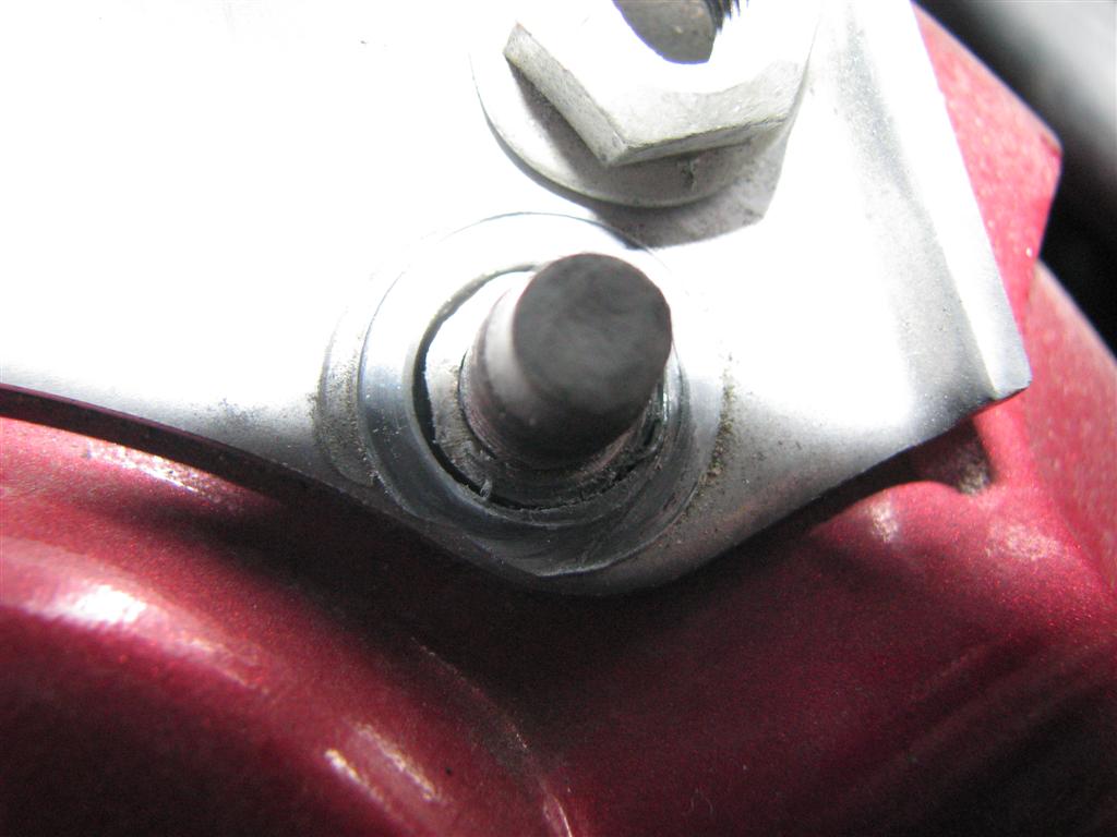

Originally Posted by John H
The hole in the strut tower brace is larger than the stud it fits over by quite a bit. I took some stainless steel nuts and drilled out the threads to fit securely over the stud and then ground off the wrench holds to fit inside the holes of the strut tower brace for a tight fit !
Oh, okay. Now I see what you're saying. I couldn't picture what it was based on your earlier description, but now it makes sense after seeing it. I wish I had the ability to do that to fill in that free space as well.
A picture is worth a thousand words
Originally Posted by metroplex
The free space isn't a problem. Just torque down the nuts and it'll be fine.
At 15 ft lbs of torque the free space is a concern, the tighter the fit the better. You wouldn`t leave that much space in a shock mount or a sway bar now would you ?
It's not a concern because it doesn't move. I have yet to find rub marks from the studs/brace moving around. 15 ft-lb doesn't sound a lot, but when you look at how the brace, stud, and body is bolted together, the movement is a non-concern especially when the other 2 studs for the mounts are bolted tightly to the body/chassis. The spacers wouldn't hurt, but I don't see the need especially when the GT500 doesn't use spacers either.
