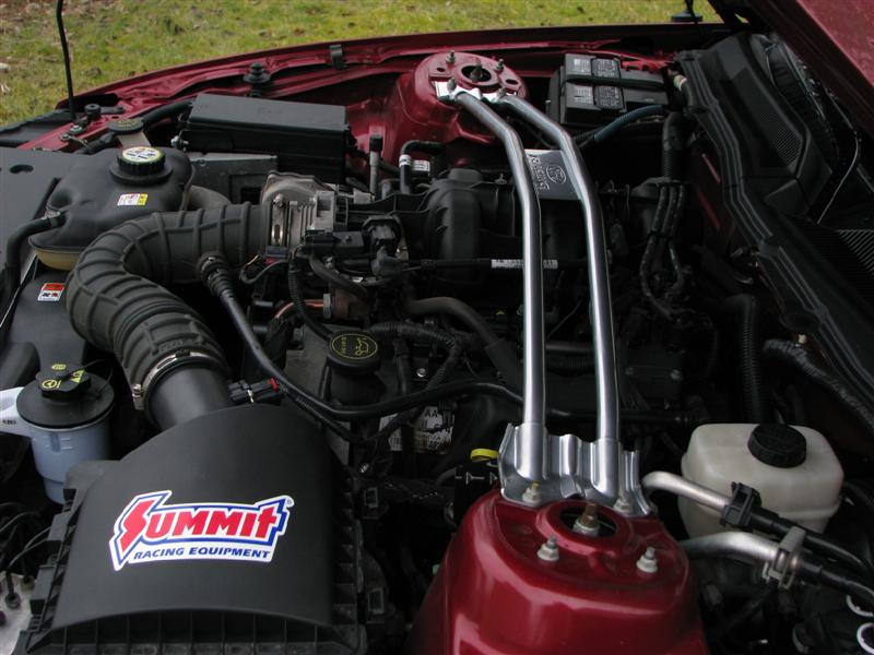

Old Mar 10, 2010 | 07:36 AM
partsbill's Avatar
Joined: March 7, 2008
Posts: 142
From: Lake Worth, South Florida
the FRPP GT brace will not clear the manifold cover, the FRPP V6 brace is the same brace that's used
on the Bullitt, that's the brace that I have, clears cover, looks good, and the car does seem a little tighter when I throw it in a curve.
