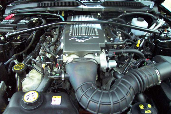

My single Granatelli STB cleared my Ford plenum cover with some clearance. Have a look, I had to do this.

Will the Polished stainless clear the Ford plenum cover installed on an 05 GT?
