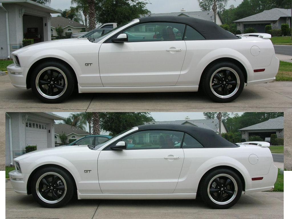

Hello all. I am finally getting to post pictures of mods to my car. I have a 2006 Tungsten Mustang GT. I got Steeda Ultralites springs installed this weekend. Here are before and after pics. The first is before and the second is after. I have SLP loudmouths on the way also!! Thanks to everyone for the info!

looks great, I ordered a set last week and should be here by monday. I will get them put in this week. Your pic has convinced me to do the whole set, I was considering just doing the back springs for now.

Looks good!!! I did mine this weekend with BMR Springs, good gravy this install was a PITA!

Thanks for the compliments! I had a place called Speedtek do it for me. I could probably figure out the rears but I didnt want to mess with the fronts. I am somewhat mechanically inclined but I have done (what I would call major) mods to a car before.
SAMS66, be careful that the tight wound coils on the rear springs go up into the car, and the loose wound side go on the axle. The directions dont tell you that and the place that did mine put them in upside down at first but fixed them no problem. If you look at TACOBILL's write up he states that he called Steeda and they confirmed the direction.

SAMS, Ride is good It feels a little tighter but not kidney busting tight(I like the ride a little tighter). Chekced the panhard and it is not off by much if it is at all. It is hard to notice with the naked eye, I will try to measure it tonight or tomorrow and get back to you. I still have stock wheels and tires and have read it is hard to tell with them on. Whne you get wider tires it is more prominent.
I got an alignment and the guy told me it is all within tolerance, not exactly on the money but everything was green. It seems to pull slightly to the right still though. People have said on here that the factory builds in a pull to the right to keep you from crossing the line if you fall asleep. The guy at sears said he didnt know of that. Who Knows.
