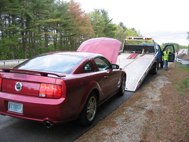

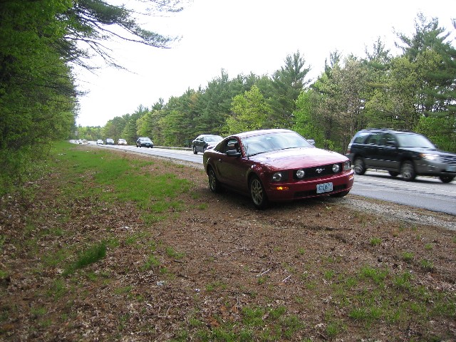

Steeda UDP + Electric Water Pump = .........
a broken azz alternator
Attached Thumbnails Steeda UDP + Electric Water Pump = .........-img_3964.jpg   Steeda UDP + Electric Water Pump = .........-img_3968.jpg

Don it drains the battery way down and makes the alternator overwork
