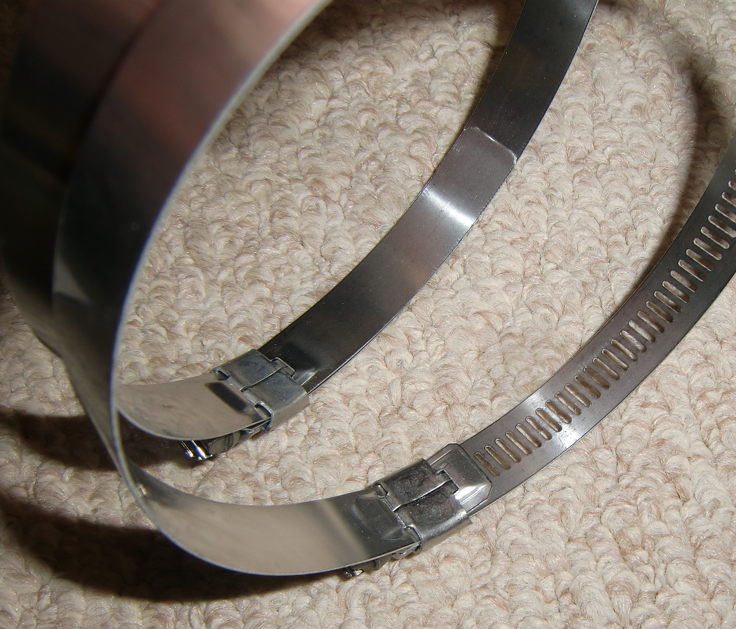

The instructions were easy to follow and straight forward. I cleaned the silicone couplings with alcohol, and cleaned the elbow with alcohol as well. I chose to buy and use liner clamps from McMaster-Carr (Stainless, size 64 and 72) because the standard worm gear clamps that are included have grooves that can cut the silicone. Usually T-bolt or Liner clamps are used with silicone hoses.

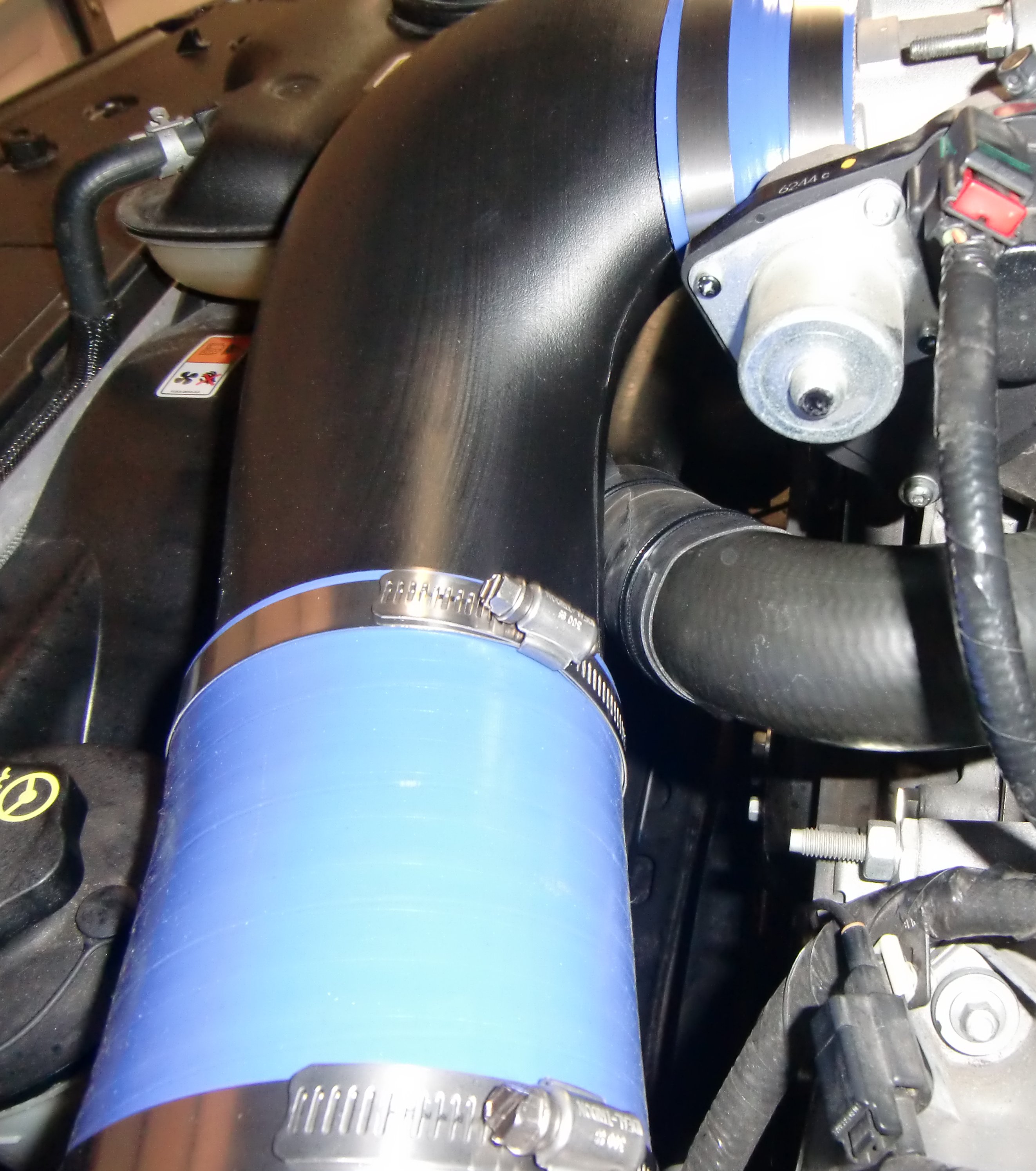

The Steeda elbow is not very flexible, it tends to stay in place with the couplings attached. The only way I could get the elbow installed was to first attach the couplings to the throttle body and MAF housing, then finaggle the elbow into place.
There was contact with the upper coolant hose. After some adjustment of the elbow, it looked clear - but after I started the engine and ran it up to operating temperature, the hose either swelled or the elbow/couplings shifted and it contacted. There was no way around this contact. The siicone coupling barely clears the power steering reservoir.

I ended up using a long piece of bicycle inner tube with some nylon ties on the upper coolant hose to protect it from rubbing against the elbow. I know I am going to hear a dozen or so replies from people that "ran the elbow for eleventy billion miles and 7 years without any problems or contact" but this is what I observed on my 2007 GT.

I also figured out why a lot of the Steeda elbow users are saying they don't have any rub with their coolant hose - the bulk of the users have 05-06 Mustangs. Ford changed the upper hose routing for 07-up.

I am not too concerned about the PS reservoir, but I was concerned about the upper hose contact. I removed the entire upper hose and trimmed about 1/8" off the thermostat housing end of the hose. I also replaced the horrible OEM hose clamps with some Ideal-Tridon Series 65E all-stainless #28 liner clamps. Now there's enough clearance between the upper hose and Steeda elbow.

Even with the hose pushed in forward towards the t-stat housing to give several mm of clearance, the hose swells up when the system is hot and pressurized and there is still contact on the intake elbow. I suspect this will heat up the air going into the engine, defeating the whole purpose of the cold air intake.

If only the silicone coupler (hose) is making any contact with your upper radiator hose, there shouldn't be any heat related issues.. If on the other hand should any part of the plastic inlet elbow make contact, then yes I would most definitely be very concerned !

Like I said before and before, the plastic elbow is sitting right on the upper coolant hose. Even with enough clearance when cold, the upper coolant hose swells enough to directly contact the plastic elbow. Steeda obviously did not test their intake elbow on 07-09 Mustang GTs.

I totally agree with you and I also don't understand why Steeda didn't change the design of their plastic inlet elbow after Ford relocated the upper radiator hose in 07-09.. But the more I've thought about, the more I realize that Steeda originally designed their cold air intake for the stock inlet tubes on all 05-09 Mustangs to begin with, as they didn't come out with the plastic inlet elbows until 2006.. At any rate, Steeda should've waited at least a year longer before coming out with the inlet elbows.. Anyhow I'll be sending you a PM and discuss this with you in further detail..
