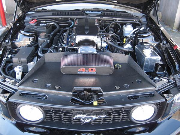

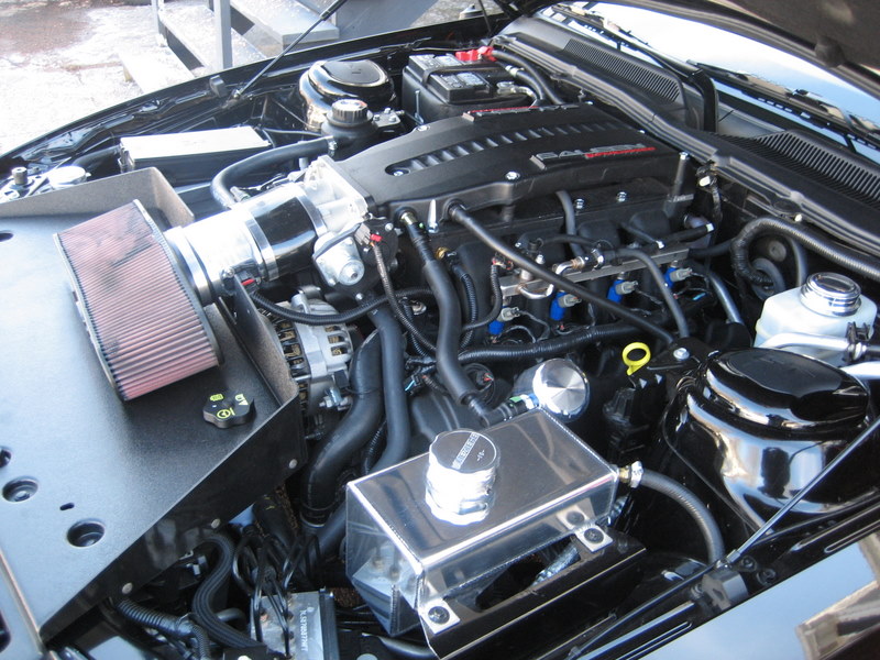

Here one that works with the Saleen and it's K&N filter
Attached Thumbnails S/C that doesn't relocate the air box?-img_0121-1.jpg   S/C that doesn't relocate the air box?-img_0123-1.jpg

Not quite the same K&N as I have... oh well.
His has a K/N style filter, maybe even actually made by K/N. But the CAI is produced by Western Motor Sports.
