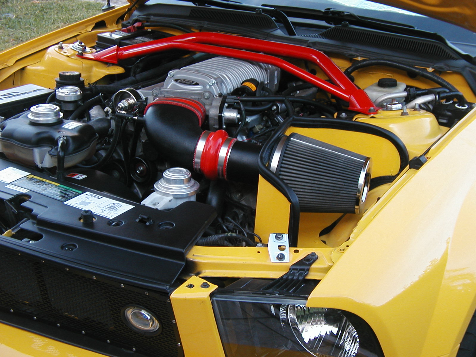

Here's my Magnacharger with the Steeda CAI in the stock location ...

Dam that looks clean^^^
Very!
