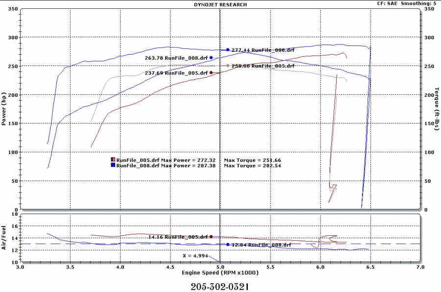

A TMS member was nice enough to send me S&B intake so I could test it on the dyno and see how well the a/f would hold up and how it behaved under normal driving conditions without a tune. Granted I didn't have a stock intake to compare it to so I cant give you before and after numbers with it but I can give you the stock tune with the S&B installed and the a/f numbers it gave.
Without the tune, the S&B netted numbers in the mid to high 13's over all with them starting in the low 14's. When I added my tune I was able to get the a/f down to a safe level of 12.8:1, starting at around 13.0.
The gains, well I dont wish to say much about them because I have cams in my car and I dont really know if that had a great deal to do with it. I gained 15 rwhp and 30 rwtq over stock with the intake and tune but like I said I'm sure that has alot to do with my special spark tables I use for the cams and I could only rev the engine to 6200 rpm's with the stock tune where I could take it all the way to 6400 with my tune.
I would still say this is a respectable intake, just like the K&N, but dont beleive the myth of no tune required. Not to take away from a good show but " Myth Busted ".

We did the dyno on a stock intake VS the GMS on four different cars back to back. I still have the results on each if you'd like to see them.
Like I said this wasn't to show numbers but rather to just check the a/f ratio's to see what it was like and if it truly required a tune. The a/f ratio's on my car never changed after installing the cams just the hp levels so it was a good test. It also allowed me to have a tune for the S&B intake now that I found the a/f ratio's to be so far off.
thanks, Doug.

The thing to remember is with the C&L they don't market it as a absolutly no tune required. They say with the insert one isn't but for the best power then it is. They'll even tell you that with the intake you'll gain power but to gain the good throttle responce and timing then you'll need a tune.

Hi Guys... I spoke with Lee a few times about the a/f ratio with the no-tune insert. He shared with me that the a/f mirrored the stock intake throughout the band (Idle/Cruise was 14+ ; but at WOT, a/f ratio ranged from 12.8 to 13.2). I'd be VERY interested in your test results as I just ordered this kit (as you know CR!).

You won't see a CEL unless you're about 15% lean or more. I dont think Doug is knocking the intake, nor am I... but it would be cool to get a wideband reading just to see, which is what he did.
