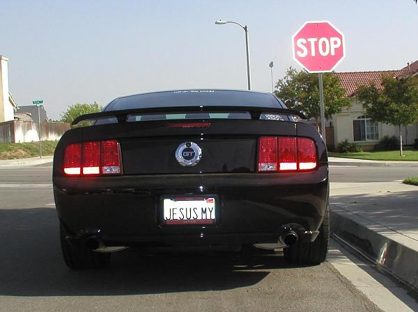

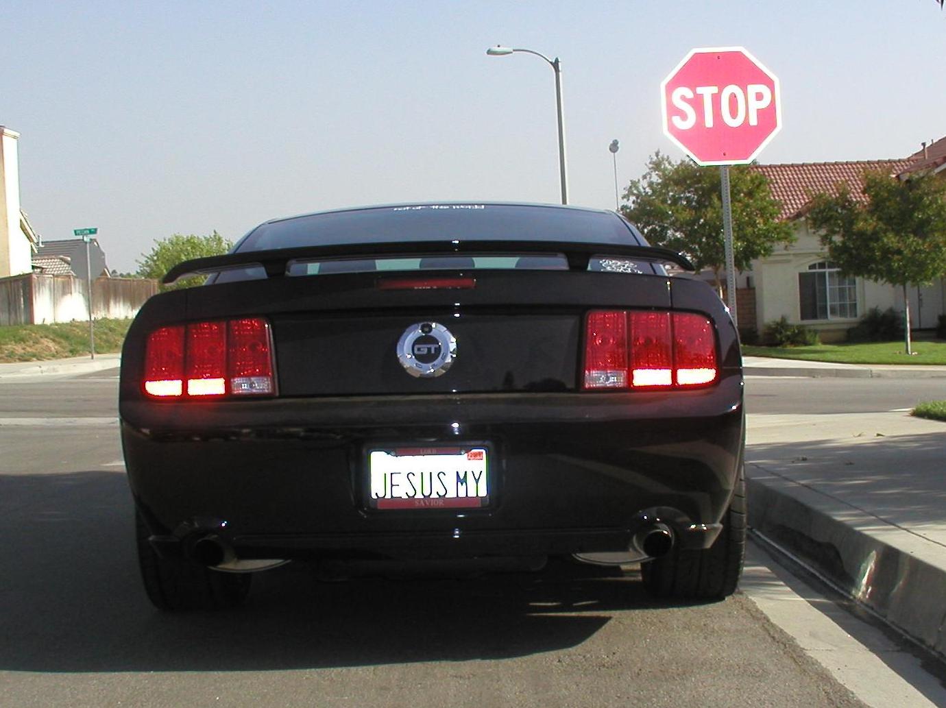

I just put new tires and wheels on a week and half ago. 18x9.5 285/40/18 in the rear and 255/40/18 in the front. The maximum width in the rear is 285, I would have gone wider if I could. I do believe the max off set is 42mm in the rear. 315 might need stick out from under the fender to keep them from rubbing on the inside of the fender. A local custom shop can help you work through this.
Attached Thumbnails Rear tires....what to do....-p5230217.jpg   Rear tires....what to do....-p5230215.jpg
