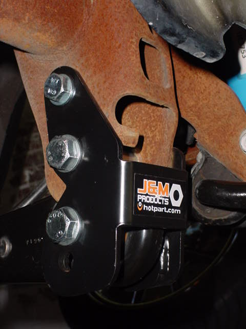

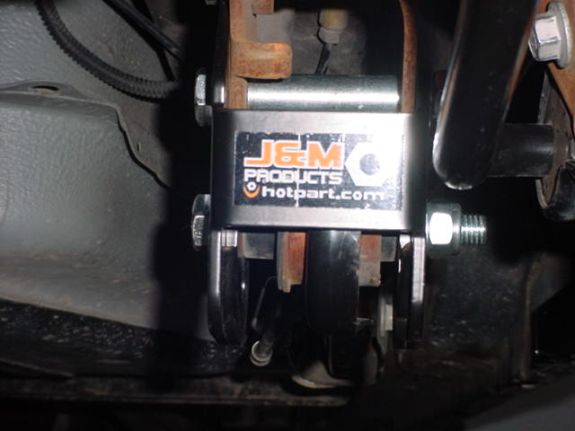

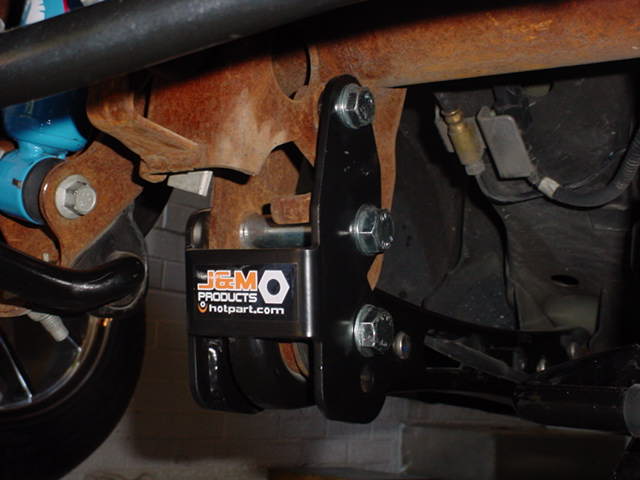

I have the J&M adjustable panhard bar, aluminum with spherical ends! no noise from it what so ever!! and the J&M LCA relocation brackets these components are well made !!

Nice looking setup. What's with all that rust stuff! Want me to buy you a can of black paint? Congrats on 1000 posts!!!!!! Slow poke!
