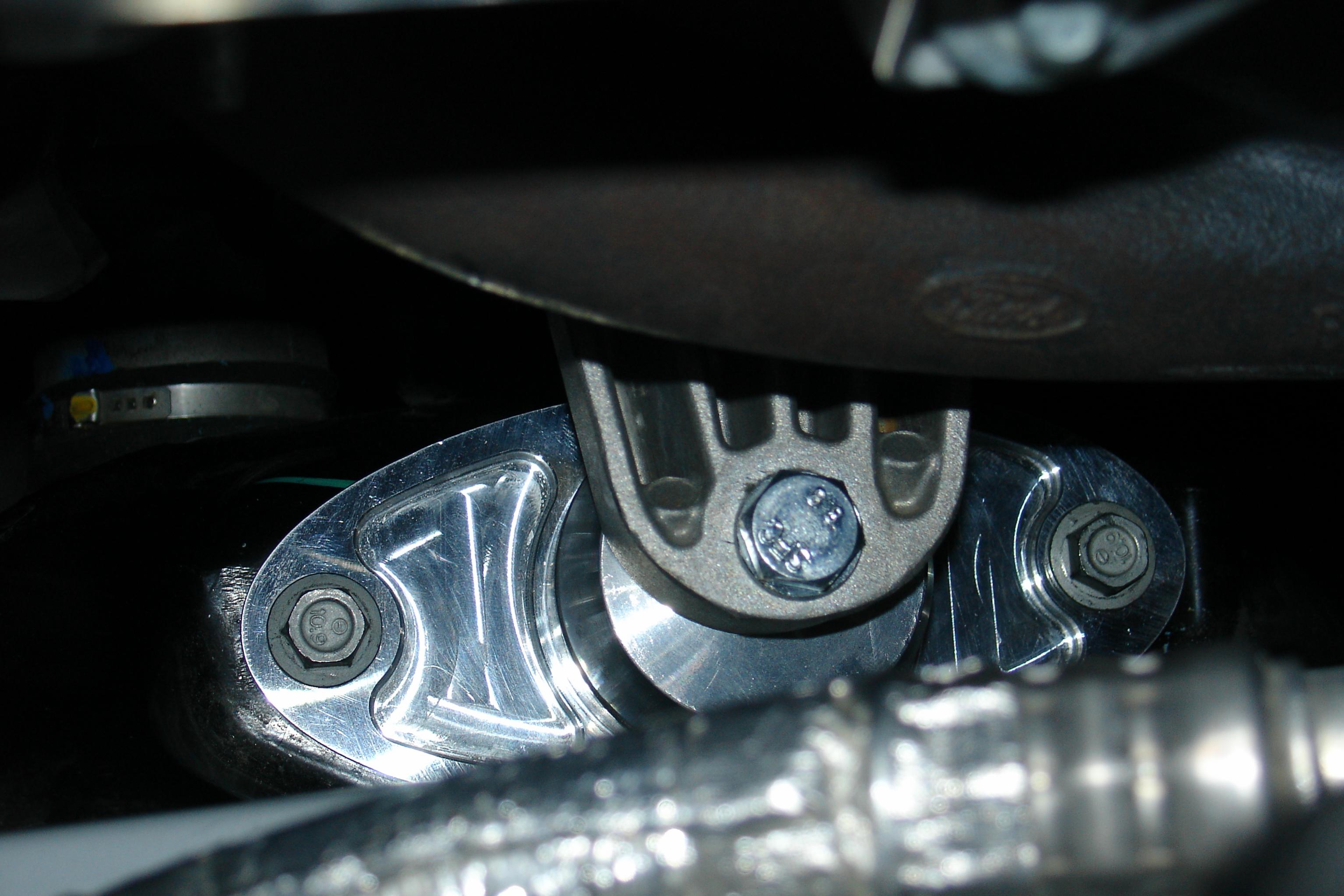

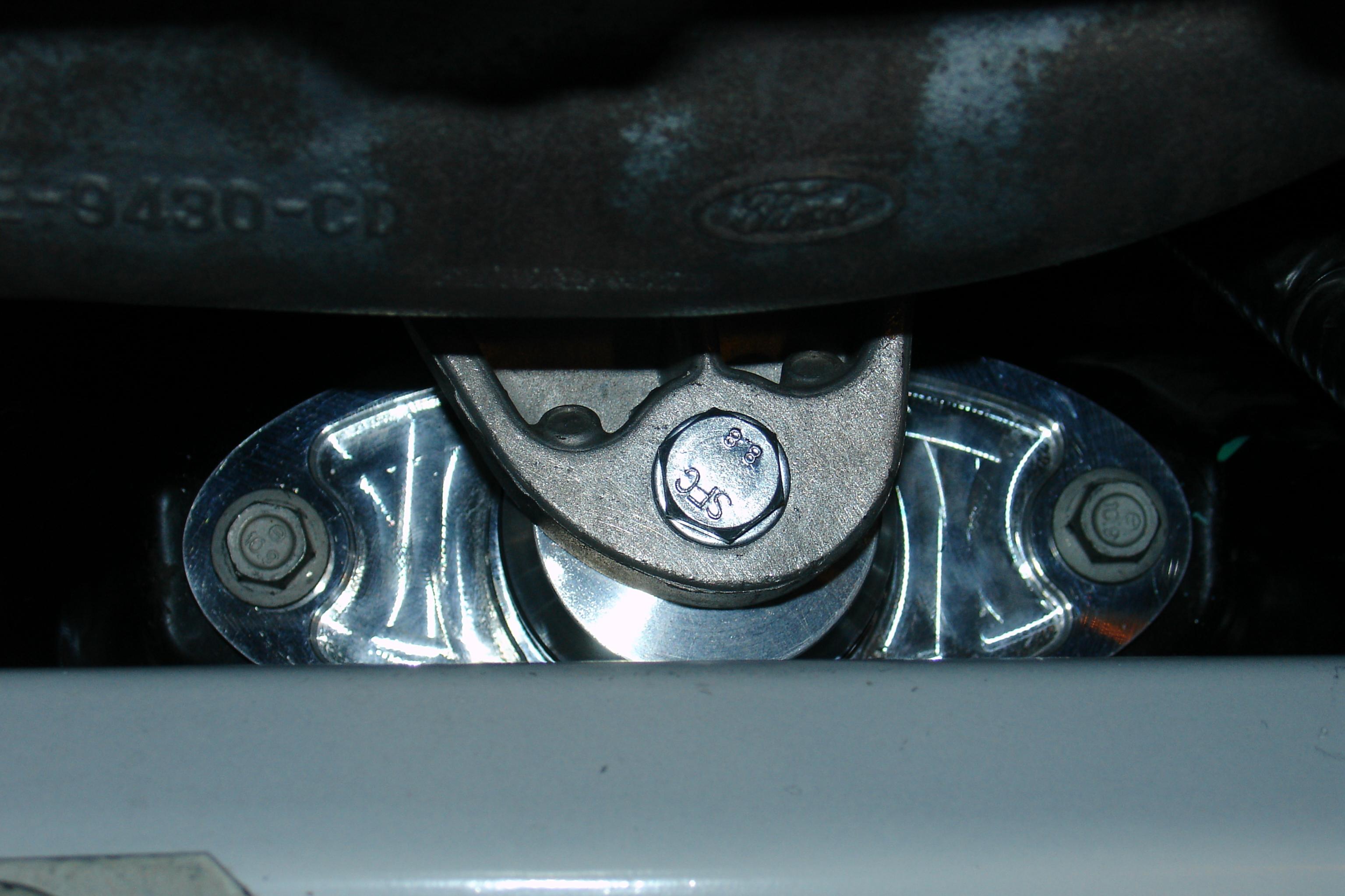

This is a very old "Taco Bill Post". But I finally put the CalStang back up on the jackstands, to get this Prothane Brand "Urethane" Motor Mount Kit install completed at last. Had purchased a set of the shortened black mounts from a fellow TMS member last Fall. Got the shorter ones because we just wanted the engine to sit a little bit lower for a future strut tower brace so it would then to clear with great ease.
As usual "TB"s install instuctions and pictures were very helpful, but he did not explain every single detail of that install process! But that was just fine. Because us old wrenches just figure out the rest and then we get it all done! Years of moding and tinkering really helps with the how-to-do aspect of solving part of this install process! First. A lot easier install for room if you remove both front wheels before starting.
One thing is that clearances to disconnect those engine mount brackets are hell-ishly tight!! You will need a good shop light, several of long socket extentions, a swivel and also the deep wall sockets before you even dream of doing this swap project! It was all very tight up under there and a just little frustrating to get your handes up in there too. The passenger side was a bit of a Mo! But just relax and take your time and you will be fine with getting it all done!
Lastly. We used the 17MM hex head bolts and washers to attach the engine mounts to the engine brackets after putting some "Black Moly" on threads. Now Love It! Money well spent!! Mounts really tightened everything up down there compared to the "Jelly Filled" stock units! And it now power shifts a lot better in the 2-3 gear change. Another added plus is that they look very sharp there in the engine bay. For when you are on display at the car show events too! See the Pix!! Our take on this great writeup! Thanks Taco Bill!! "RC"
