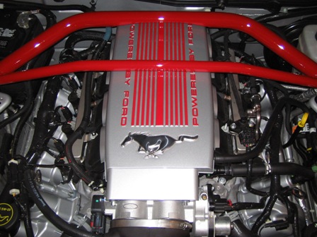

True_HP's Avatar
Joined: March 31, 2005
Posts: 88
Some mods required...
Here's a pic of mine... TB spacer could be problem but you might be able to just cut the tabs that hold the cover to the TB and use the fuel rail studs to hold the cover tight to the intake like I did....
Normally the covers just go over the fuel rail studs. If you remove the studs and than reinstall them using them to bolt down the cover it sits much tighter to the intake. Still wasn't enough for me so I had to have some custom work done to the BMR and scallop out a section and fill it back in, and have it re powdercoated....
Yes it was a pain, No I don't need either of them but I think the results are pretty **** nice...
