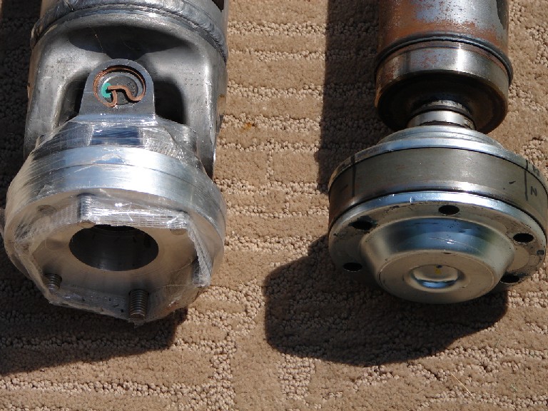

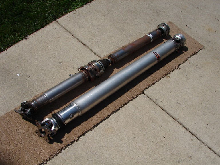

As I said in my last post you can feel the difference in the seat of your pants. Her is a picture showing the stock shaft and the Powerhouse shaft.
It is good for 2 or 3 tenths in the 1/4
Attached Thumbnails One piece Driveshaft help-shaft.jpg   One piece Driveshaft help-shaft1.jpg
